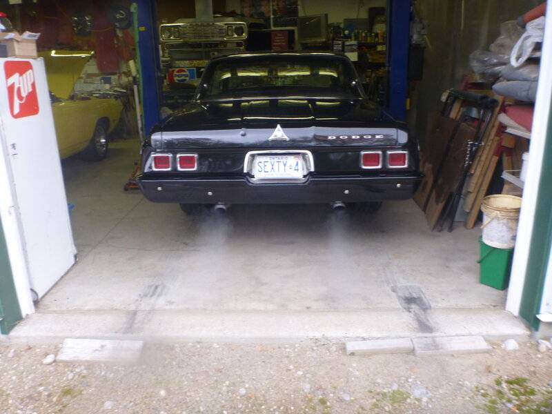

Much to my surprise, I found my "new" acquisition is an open 3.23, despite the fact it can smoke both Cobra P275's !
