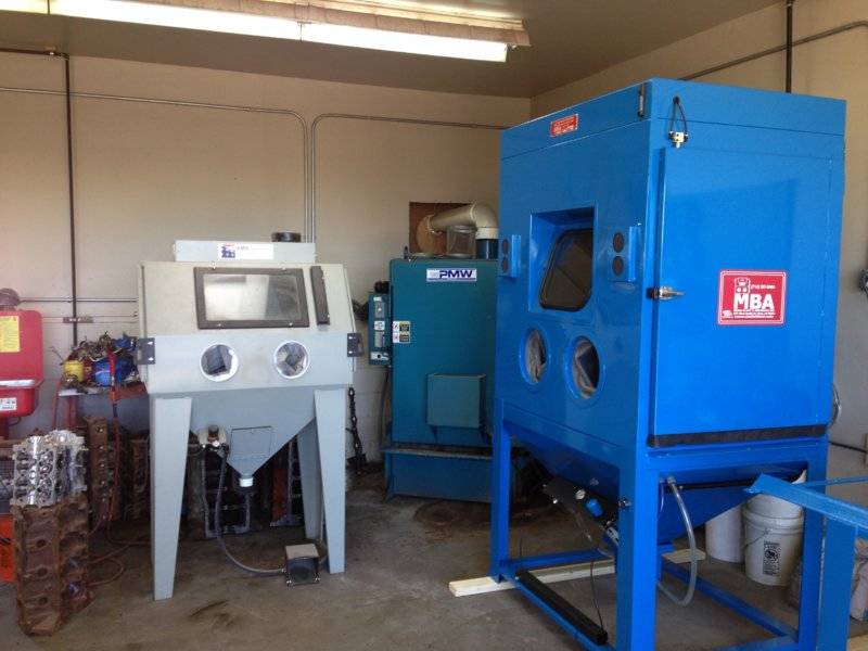

I had a freind that bought one from Badboys he does some pretty big stuff this isn't his model but I found this short video
Please tell us more...

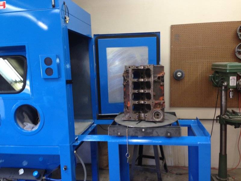

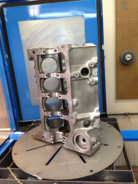

What would you like to know? I ordered a 42"x24" clamshell model from "blast it all", and the company I ordered it thru sent the wrong one. I tried it, but hated it. Too small for my needs, and didn't like the reclaimer on the back. It always wanted to tip over as I didn't bolt it down. In a fit of frustration, I ordered a custom job from MBA (Media Blast Assoc), and an very happy with it. I added the rack and trolley system to load heavy items like blocks and diesel heads. The cabinet is 48"x36" and the door opening was raised to 36" over the turntable (40" opening). The reclaimer is at least double the size of the other one, and uses a huge dust filter. The only downfall I see is if I blast smaller stuff out of my hand into the back left corner, I have to use a magnet to retrieve it... :thumbsup:

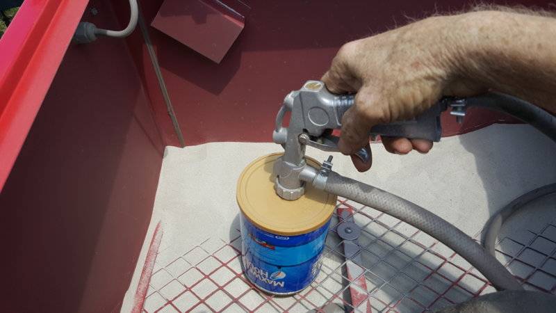

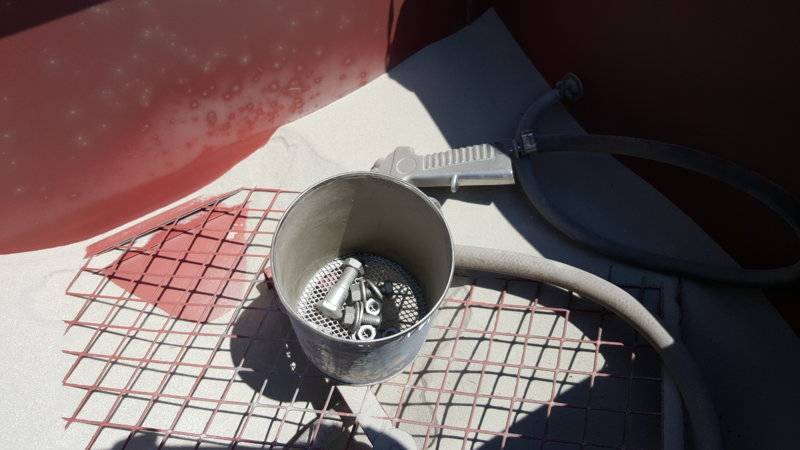

Here's a little trick I used for small parts and hardware.
