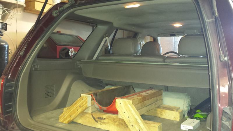

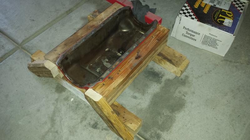

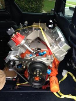

Made from scrap wood, used oil pan as template. Eyelets mounted on all 4 corners to keep the engine from shifting on the cradle and to keep the cradle from sliding around it was secured to factory D ring mounts in my Pathfinder.
Everything was ratchet strapped down.

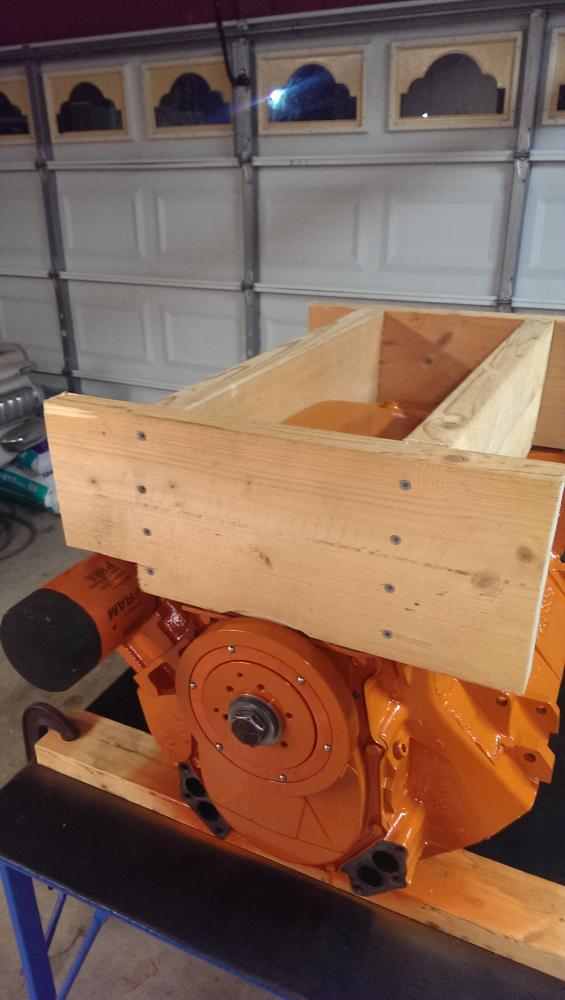

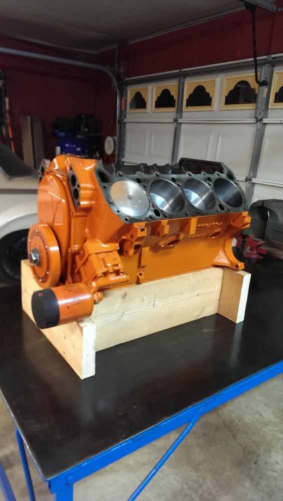

I made this one so I could work it on the bench...(Fram is for paint and protection only!)

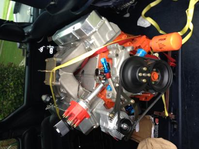

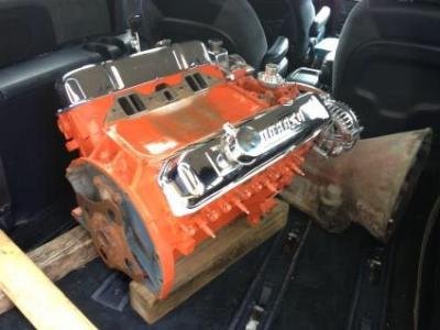

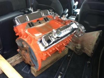

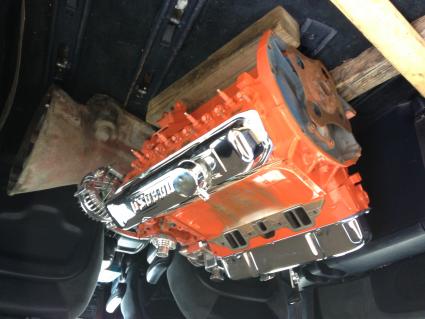

Here's how we did it in the old mini van! It actually worked perfect with the seats out ran the straps through the anchors. Lolimage.jpgimage.jpg

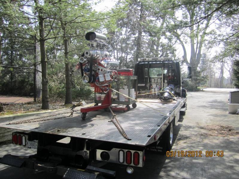

Depends on what your using for transport.This was on the way back from the dyno>>>>>>>>

Need an old HD one that was made in the USA. Bet there's over 900 lbs on that stand,,,,as it stands:eusa_whistle:
Stand was purchased before I knew HD existed had a 750 lb. rating. Was bounced across RR tracks in a stock trailer with a 383 long block on it. Tore the riser from the base at the weld.

Transport by stand looks scary. I don't trust three wheel stands since tipping one over with a full 440 on it. I was able to rotate it back onto it's wheels with a surge of adrenaline! That was 30+ years ago. I'm dreading the 8-3/4 rearend change coming in a few months...my back isn't what it used to be.
