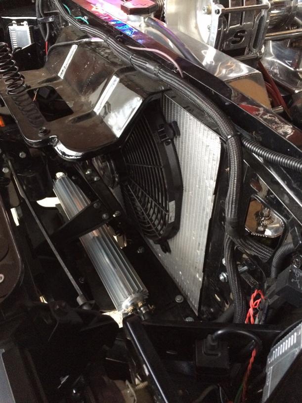

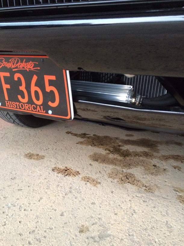

well, good news and bad news. taking the trans lines off the radiator and mounting the separate trans cooler dropped the engine temp by about 10 degrees so I think its gonna be as good as its ever gonna get. bad part is after driving around town for 30-45 min while outside temp was 45 degrees the tranny is getting pretty warm, guess I don't know if its too hot but I can garuntee on a 80 degree day it will be. creeps up on 230 but then when you get out cruising at 45-60 it cools off pretty quick but starts heating up again pretty quick when you hit traffic. I never let it rise above 230 but I know it would have. only a 2800 stall which is kinda suprising its getting that warm. guess i'm out of options other than a few, running tranny lines way to the back of the car and remounting the cooler and finding a fan to put somewhere to blow on it, if I remove my front licence plate I would get more airflow across mine but then I gotta deal with the cops
I will try post some pics later if I get time on how its all mounted and setup, btw the new spal straight blade fan is way better than the last 2, can tell a huge difference just holding your hand behind fan
here is a picture of how and where I mounted the cooler, cant believe it still gets as warm as it does, still looking for ideas on how to cool down that tranny!IMG_1457.jpgIMG_1458.jpg
