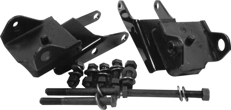

so I looked a bit online on pictures of solid motor mounts and looked at the car and what I THINK happened is this, there is the "lower" motor mount or stand whatever you want to call it and there is the motor mount that's bolted to the engine, all 3 bolts are in and tight that hold the motor mount to the block, this I am 100% sure of, then it looks like there is a bold that holds that motor mount down to the stand or "lower mount" and that is the bolt that is snapped off. I have never put one on so that's why its so confusing to me but all that aside atleast there isn't anything busted off the block and so on.. here is the next question I got for you guys,
do I try and jack the motor up to get the mount out, fix whatever is screwed up and re install or is the only way to do this to pull the engine completely? I think if I remove my wiper motor I can jack the engine up a little bit anyways and maby enough to get the thing out and really see whats happening, I cant believe there is only 1 bolt that holds the mount to the car itself but maby im mistken and there is another bolt hiding on either side. either way what you guys think on how to swap out the mount?
MD7102.jpgwas trying to post picks but its all black so pretty worthless, just wish I could find a pic of whats mounts I got outside of the car, closest thing I can find that I think they look like is this, and the stud "or bolt" you see that holds the 2 halves together is whats busted on mine
