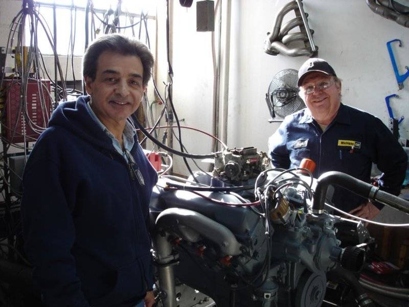

Is that your motor that Bob's testing? Looks like an Eddy standard Performer intake. Don't see that combo on a dyno every day.
It is...he built me a reliable driver motor. I actually had to dump that intake because it wouldn’t clear my ramcharger setup.

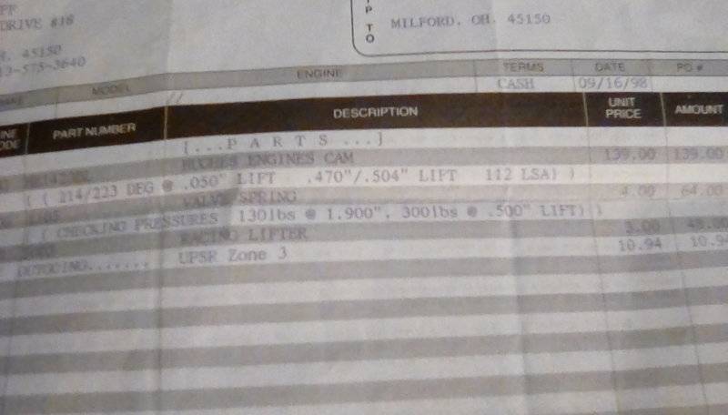

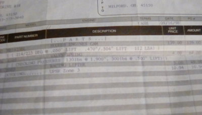

The flip side is, if the cam you have now is too big, you will probably see a noticeable improvement. Do you know the size of the Hughes cam?
Good luck. Have fun. Go to the track. You won't regret it.
Hello, heres the specs from 1998
Not a bad cam at all, but you've definitely moved up the power level ladder with the Bob K cam. You might not feel much improvement down low but power should be up overall by more than just a little IMO. Time will tell. Report back
