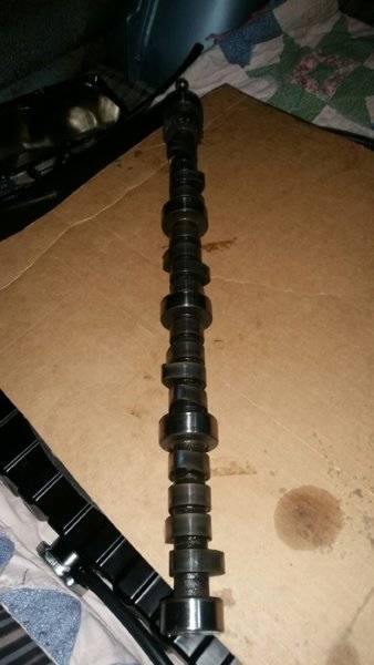

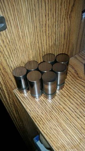

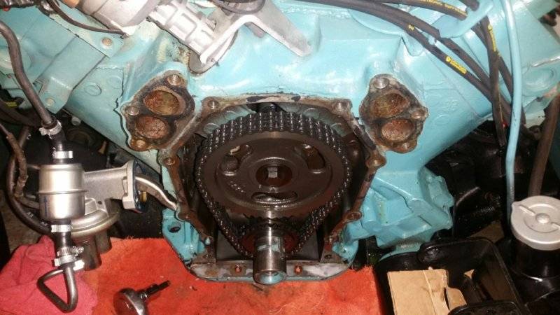

Getting ready to install bob k cam. The cam pictures are hughes engle cam and lifters from 1998 probably 15000 miles on them. We broke this cam in for 15 mins shut it off buttoned it up and were done used Kendal 20/50 oil .cam lobes are still in good condition. Imagine that good oi! And usa made parts.

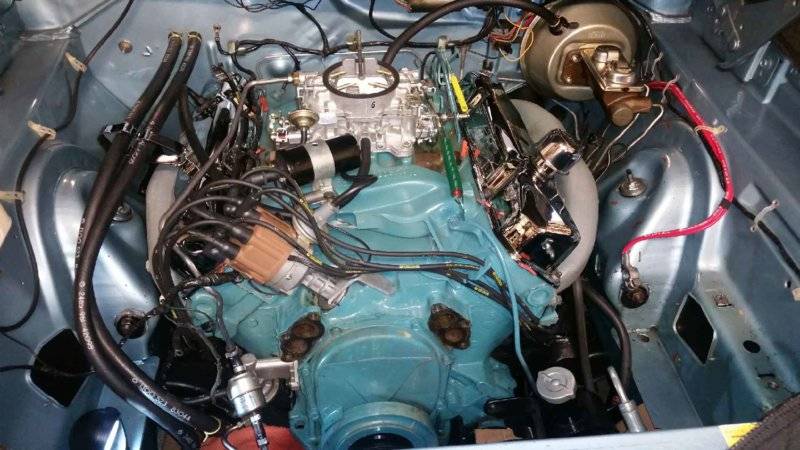

Broke the bob k cam in today, 95 outside running 440 at 2300 rpm for half hour maxed out my 120 degree thermometer in the garage, that was 3 hours ago it's still 90 in garage with ac running. Oil changed new filter installed. Knock wood pretty much uneventful cam change so far hopefully it stays that way. I used Kendall titanium 20w50 zinc formula as recommend from engle cams. Need to adjust timing put grill back together then see how she does. Hit the throttle several times during break in and it was very responsive. As a side note mr 6 pack said he had surgery to remove his appendix and he was in recovery when he responded to some information i forwarded to him. Lets hope he gets back in short order.
