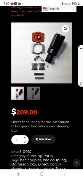

I agree with Kern Dog. I also got my kit from Bergman. Since you already have the box, you can order the coupler from Bergman.
I went with the hybrid coupler kit also from Bergman also. Installation tip; your steering column is the collapsable type, least my 73 is, and it will need to be loosened up. Mine was frozen/rusted in place and when I finally got it moveable , installation was a breeze.
If you haven't found out yet already, the box you got will most likely not have the correct fittings you'll need to hook it to your pump. Another thing BAC rocks at. Correct coupler and fittings.

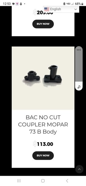

I forgot you had a 73 you more than likely need this coupler instead
I have a 71 so I used the coupler I first poated a picture of. No clearance issues with that coupler and my TTI headers. The fitting adaptors for the hoses you should be able to buy at a local hydraulic hose shop. Take them your new box and your hoses and they be able to sell you the adptors. Or call Peter at Bergman and ask him if he sells the fittings if you decide to buy the no cut coupler. Remember whenever you decide to modify a vehicle there will be things to work through.
I forgot you had a 73 you more than likely need this coupler insteadView attachment 1494282
Ya I know I'm just getting super frustrated lol, anyway ya I'ma buy the coupler and return the other one. I was always Shakey on cutting the steering column. So if I can avoid it, I'm ok with that
