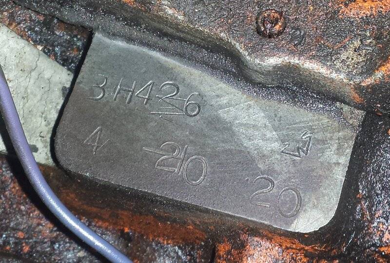

Believe 4 6 is engine assembly date. BH =66 hemi. 17th engine assembled. Maltese Cross undersized crank.
