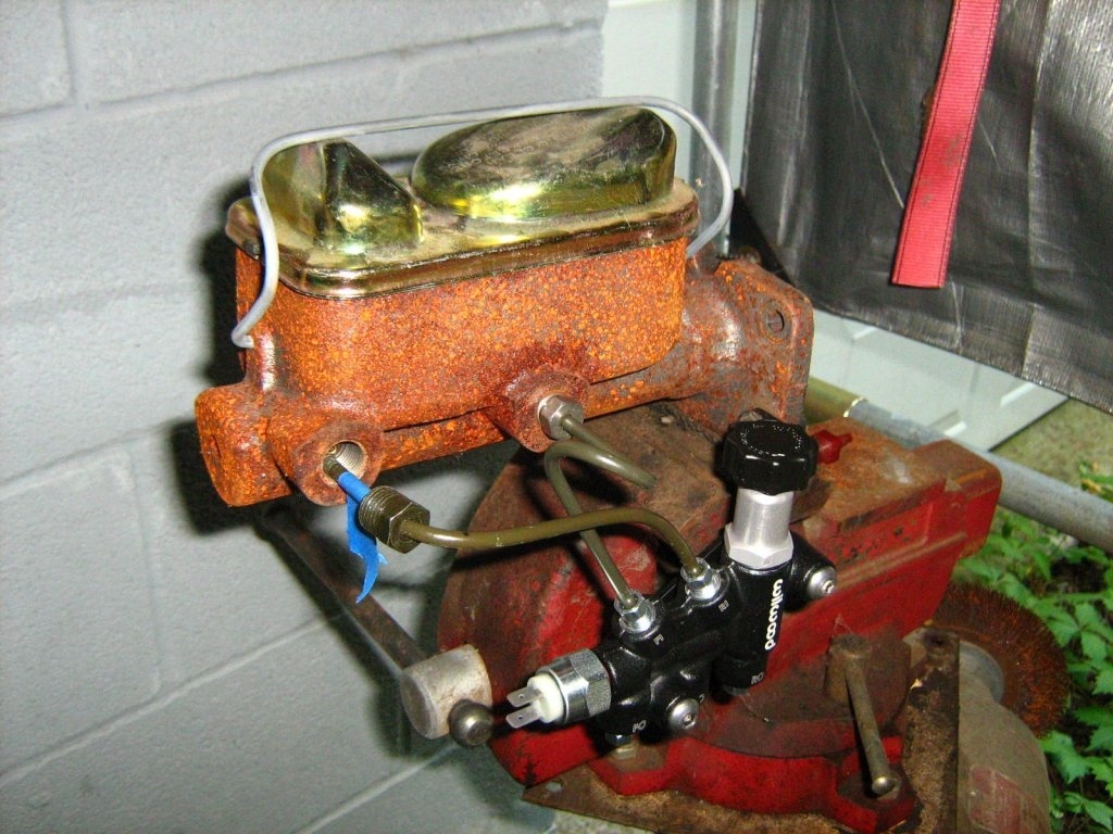

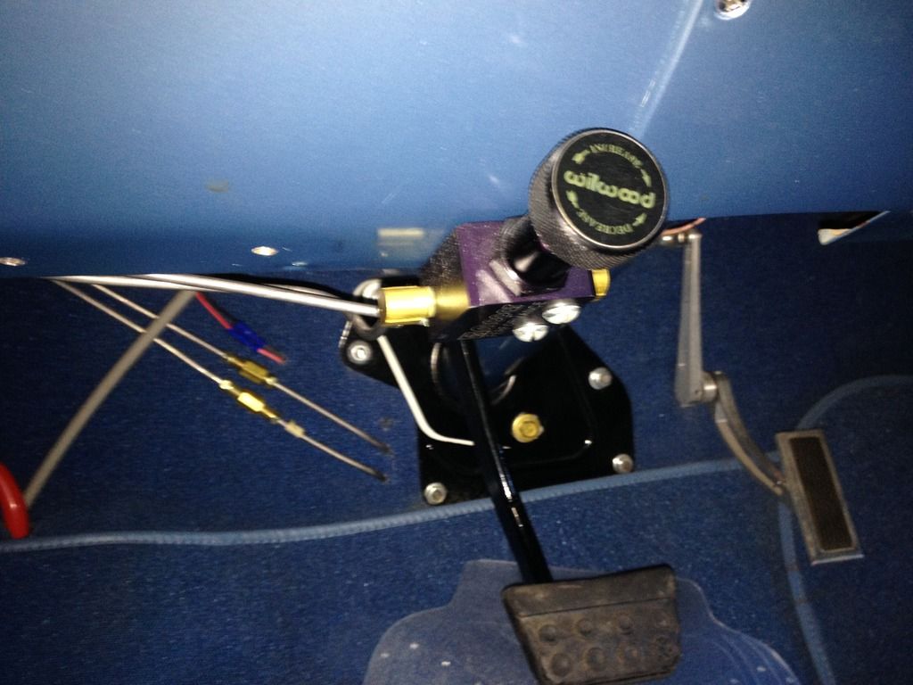

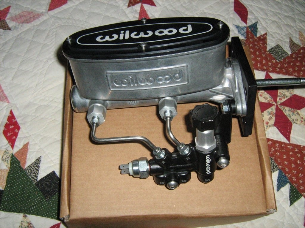

I set my adjustable valve on a daily driven car in a empty parking lot with a layer of glare ice, once set there it also worked fine on wet roads. My first valves were very much under the car about under the drivers seat. However I found the Willwood valve to be a better option, no extra connectors as all lines run to the valve.
2014-05-31-2 Wilwood Master and valve kit.JPG 2014-08-07-3 Dons master and lines.JPG
