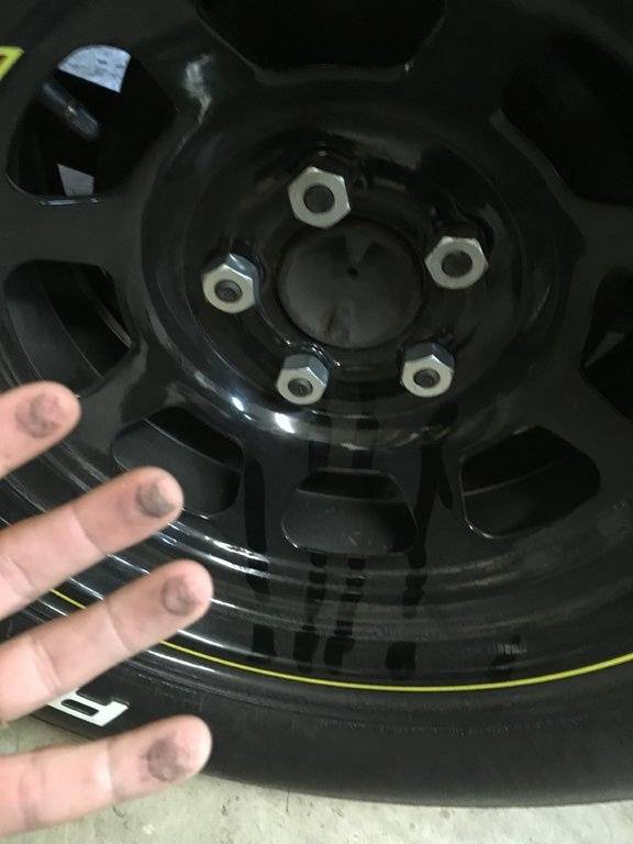

I will get a picture if it will help. And yes I get it on all 4 wheels. Im not sure what type of shoes they are, the PO installed them.
This is the RR wheel. See the dust on the inside of the wheel through the holes? These wheels have a handfull of drives on them
Has to be the type of brk shoes. Weird
If the shoes are new there could be some dust. After they wear in a bit it should be less noticeable.
If it keeps up, they might be a cheaper shoe that wears at a faster rate. If that ends up being the case, you'll have to try a better quality shoe. They don't make them with asbestos in them anymore.
There are some quality shoes available, some are even made with ceramic.

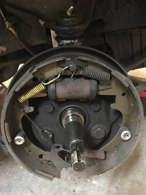

Here is a picture of my RF brake assembly, does it look to installed correctly?
