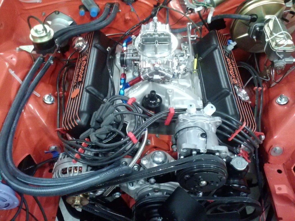

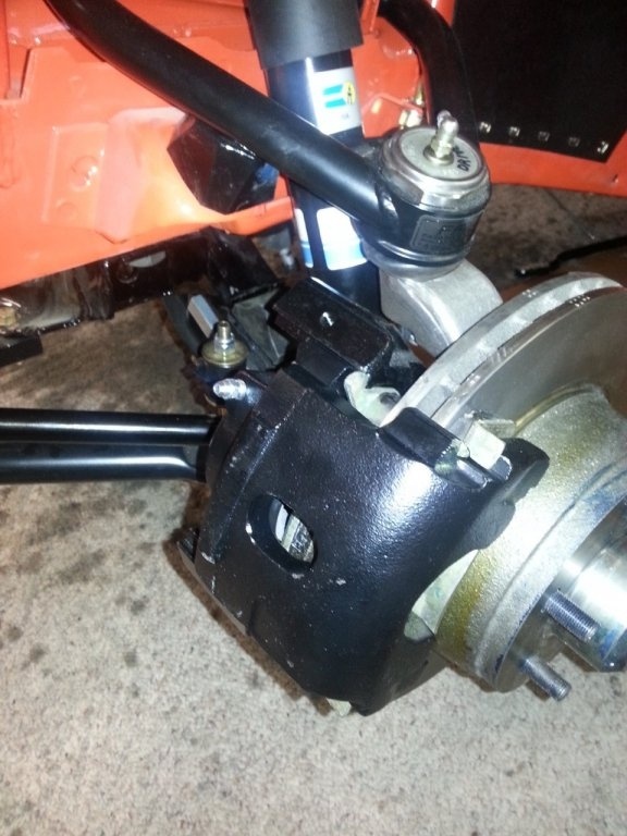

I did the same on my '71. My car came with power brakes as well. My kit came with everything for the from conversion as well as the proportioning valve, no adjustable for the rear. Have hard lines in all four corners with about 1 foot or so of rubber line going to the actual wheel. I just bled the system the other day and with a few leaks due to under tightening, I have a firm pedal. My car isn't road worthy as of yet because I'm going from the ground up but engine is ready to fire soon. Other than that, I'm happy with it.

Thanks..I see the tubular control arms too nice!

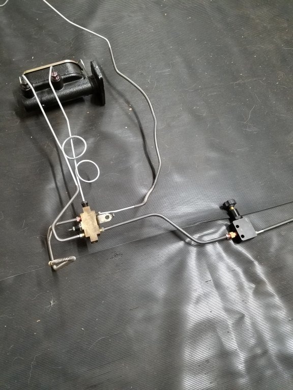

What I've learned is that you should use a proportioning valve if you're going with a disc/drum combo, with power or manual, to limit the pressure to the rear drums, so you don't lock 'em up and spinny-spinny.....I'm still using my factory manual drum valve (it's really just a distribution block with the safety switch for your brake warning light, but doesn't change any pressures) in conjunction with an adjustable valve plumbed into the rear line. The line on the front port of the M/C feeds the rear brakes, line on the rear port feeds the fronts...here's the basic layout hope it helps

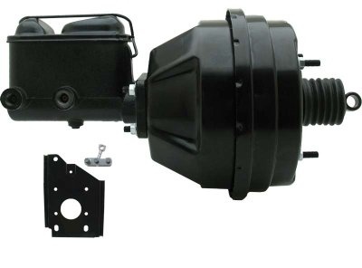

this is the Repro Bendix unit that's correct for 67 through 69 that Pirate Jack is now offering. The master cylinder even as the correct part numbers stamped on the lid, and since my car is totally stock and want to keep it looking that way, I thought I'd go with this.
