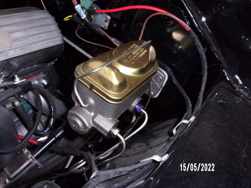

Thank you kindly as always sir - but I'm specifically asking if anyone knows of any difference(s) between the
original style drum master cylinder and the only one available from the aftermarket these days (other than the
lids, of course) as pictured??

Ed, this is the mastercycylinder I used from Summit Racing Inc. You'll notice it has a larger capacity for disc brakes, and that's what I installed on the front of my 68 RR.(manual disc)
So, if your present MC is not returning the pedal, I think it's weak at best, and should be replaced, even though general thought is that's not the culprit as for the grabbing brake on just one side.

I would replace the M/C with one for manual disc. It will work fine, and then you won't need to go through that again when you go to disc. I bought new wheel cylinders for my Dart. Couldn't get good pedal. I ended up peeling the wheel cylinder boot back, and saw where fluid was leaking past the piston. I put the old one back on. Sorry, I don't know the difference between the drum masters.
