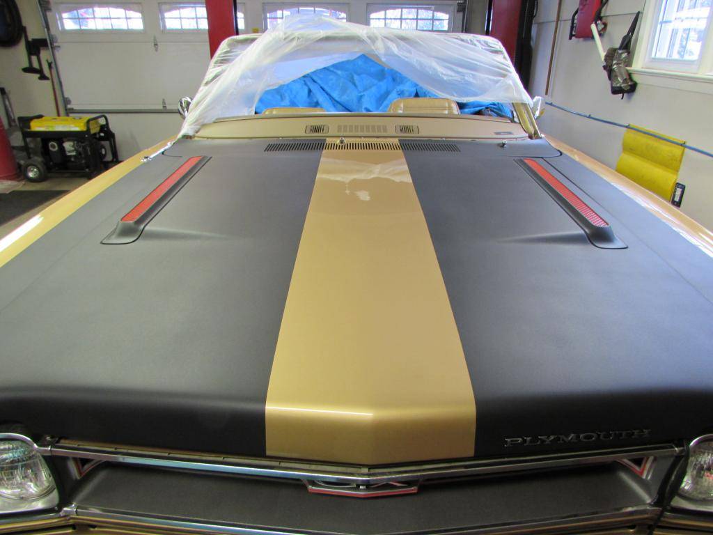

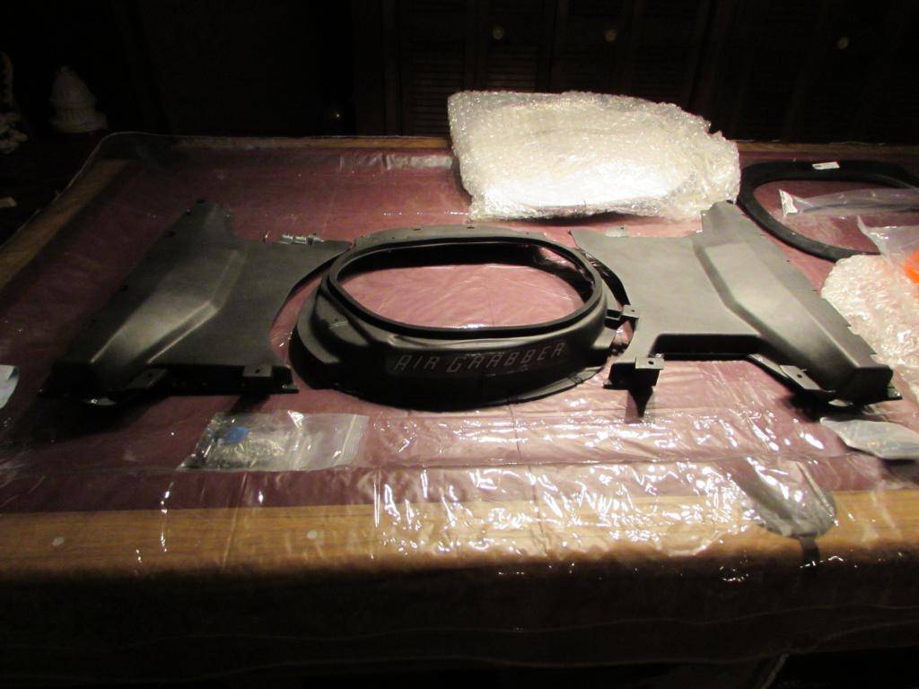

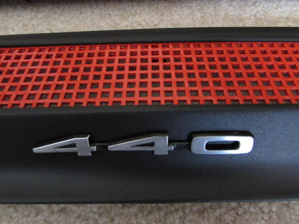

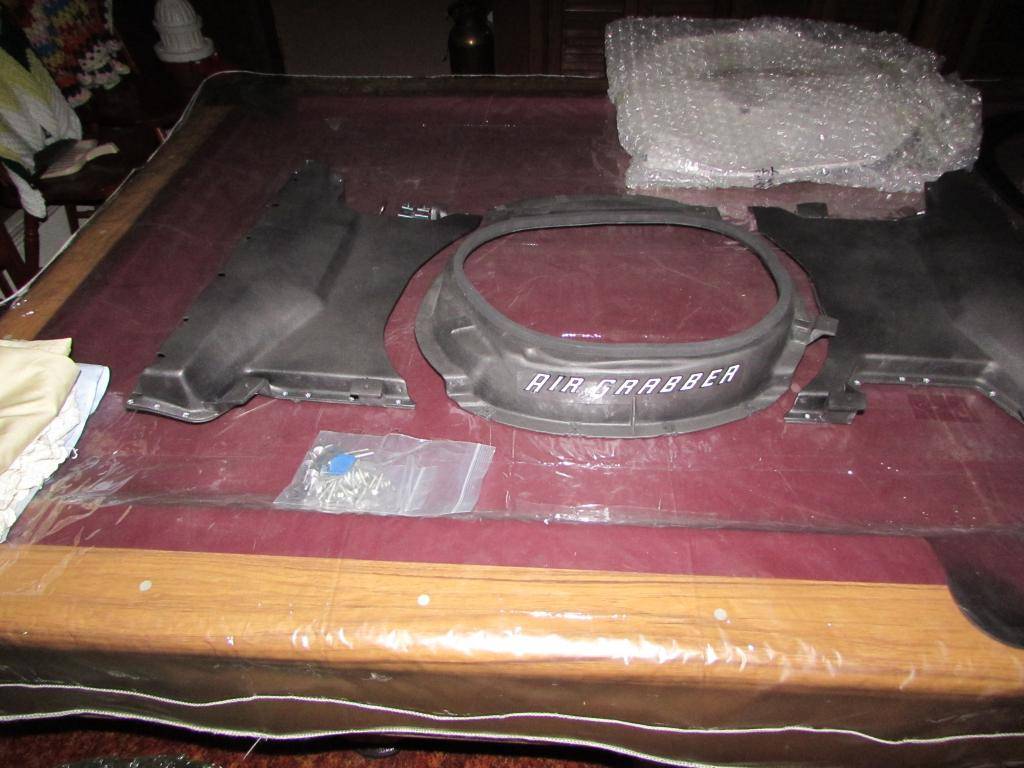

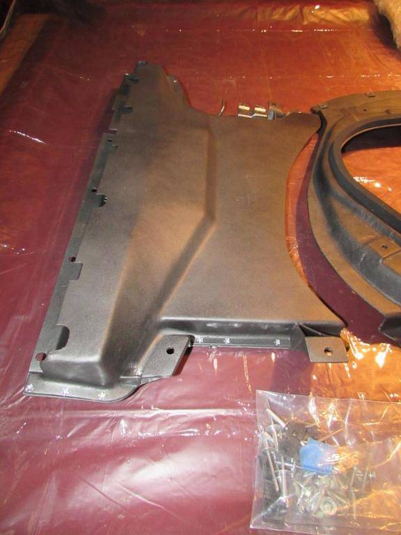

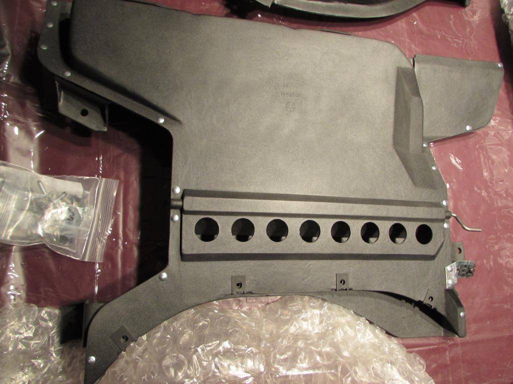

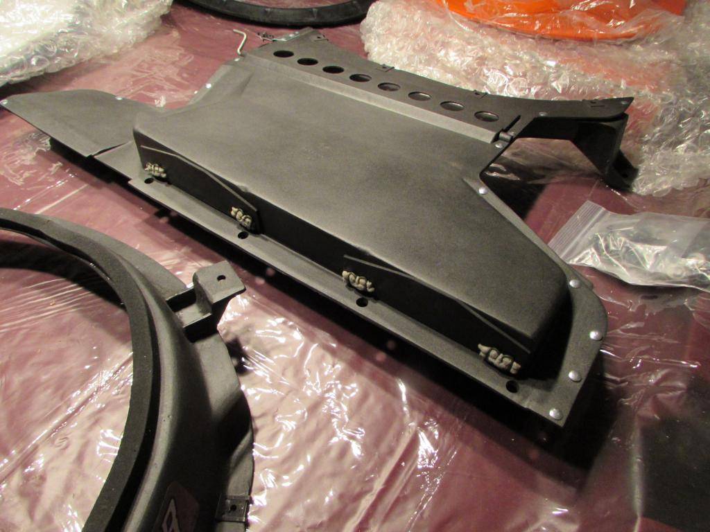

So, today was supposed to be the day that we started putting the GTX back together with starting with the newly restored air grabber system that Dad got from Russ Jenkins of Restoration Full Circle. Unfortunately, we had a little hold up as Dad misplaced the gaskets to install under the hood scoops to the hood so until we find them or the replacement set comes in, these pics will have to do for now. If you have not seen Russ' work before, you will be absolutely amazed. These parts certainly deserve to be on the GTX as the amount of detail will blow your mind! To say that these are restored to OE or better is an understatement! Russ certainly out did himself as far as I am concerned. Truly amazing work. I'll let the pics show off these fine pieces. All factory original parts that are either restored or repaired. New rubber and foam seals are included. Correct plated hardware and brackets all down to the smallest detail! Way, way better than the warped, incorrect painted, have to drill your own mounting holes repro's that are out there.

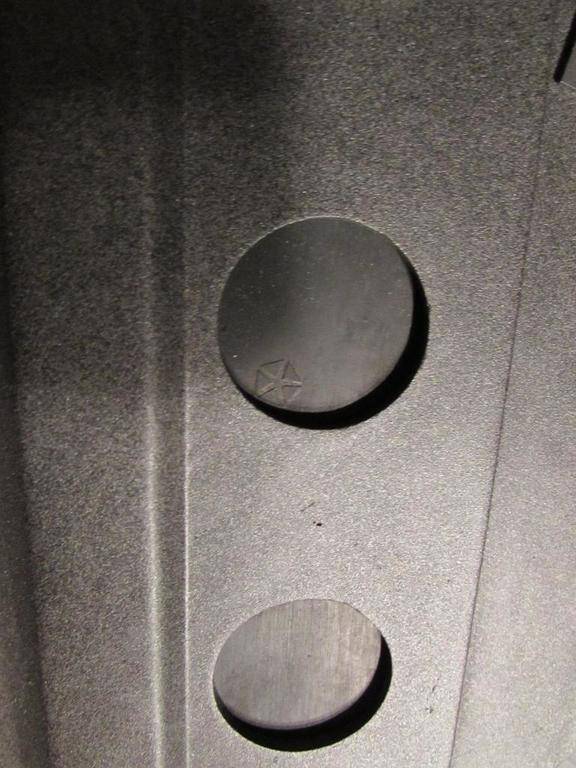

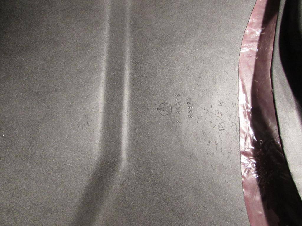

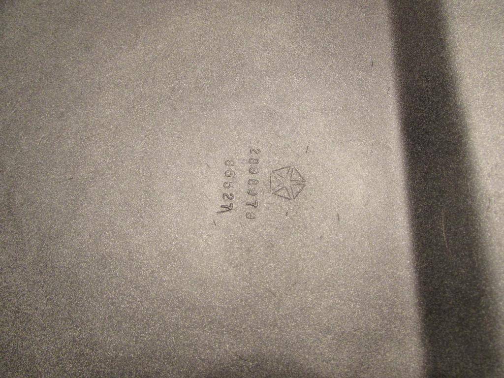

As I said, correct down to the SMALLEST detail. Pentastar logo and part number on the rubber seal for the flapper door inside the fiberglass halves.

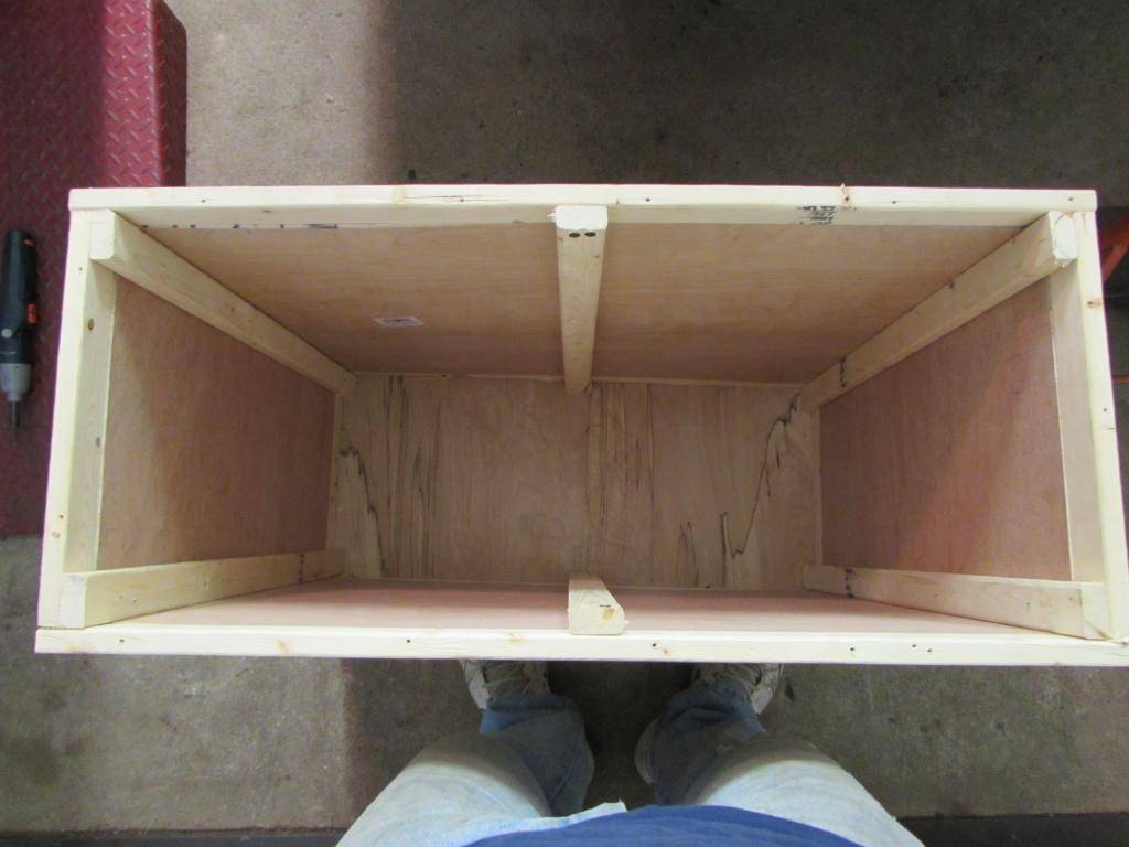

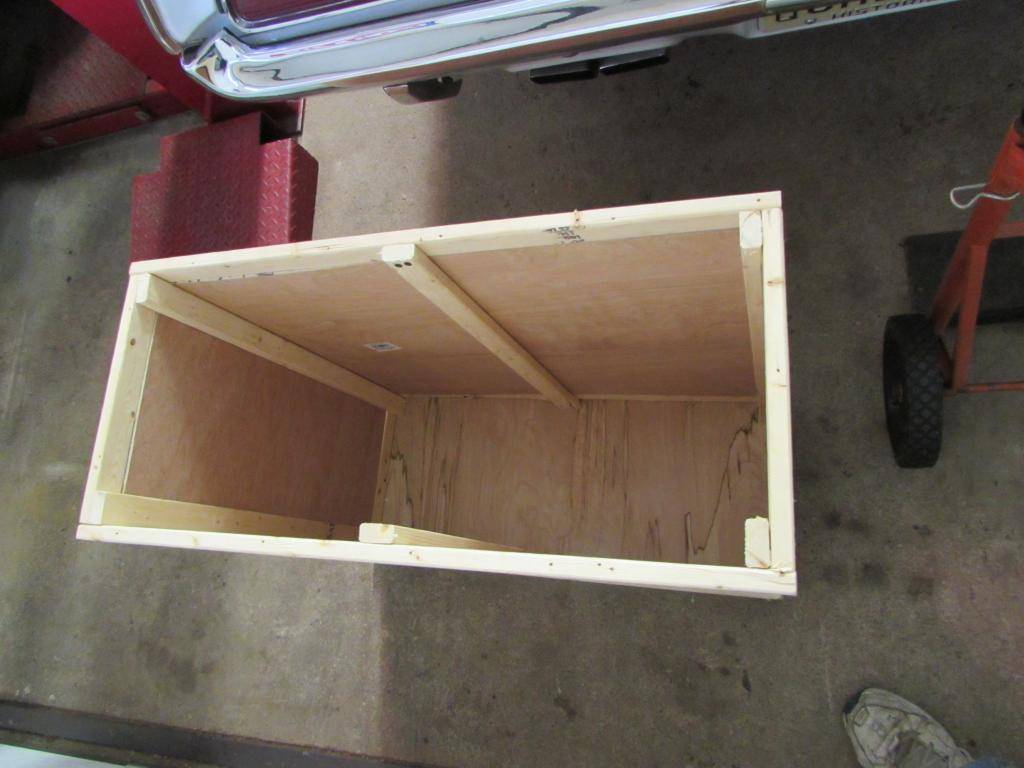

To say that this thing was protected in shipping is an understatement! Russ builds a crate for these pieces so they certainly do not have any chance of getting damaged. Even the bubble wrap inside the crate was beyond what I imagine could have fit inside the crate.

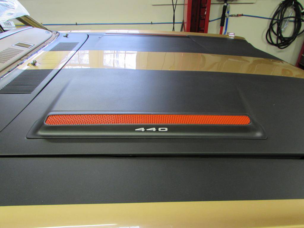

Got some major work done yesterday. For those who have not installed an Air Grabber system, its not for the faint of heart! It requires a little finessing to get it into the proper spot without cracking or breaking anything. Pass side took me the longest and driver side went right in like I've done it a million times. Go figure. lol I just have the cable left to install under the dash and its complete. More progress hopefully on Monday!
Man that thing looks great, too bad it isn't a '68! Did the car come w/ an Air Grabber from the factory? I know you wouldn't add something to the car it wasn't born with.....:grin:
eh, well, thats one of those things that Dad wanted. Its not that hard to remove if we ever wanted to return it back to true OE condition. Consider it a "Day 2" addition! lol

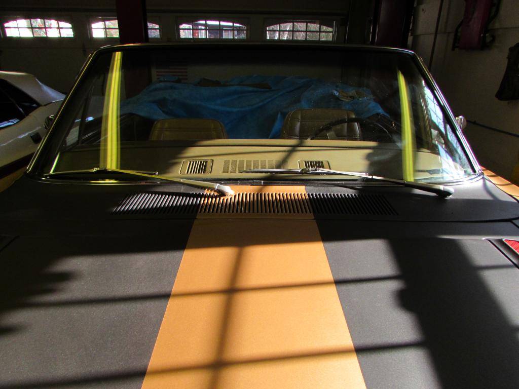

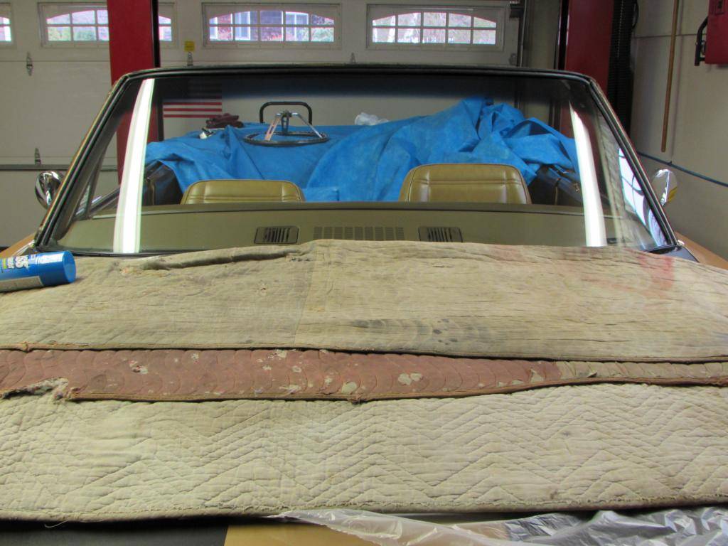

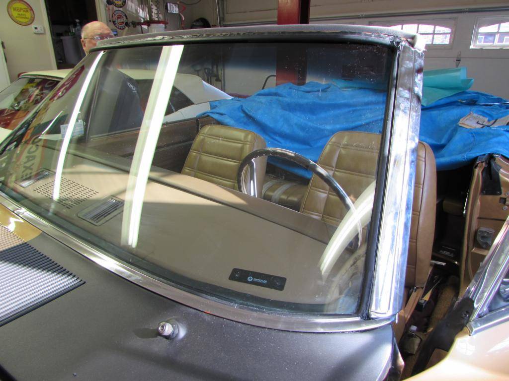

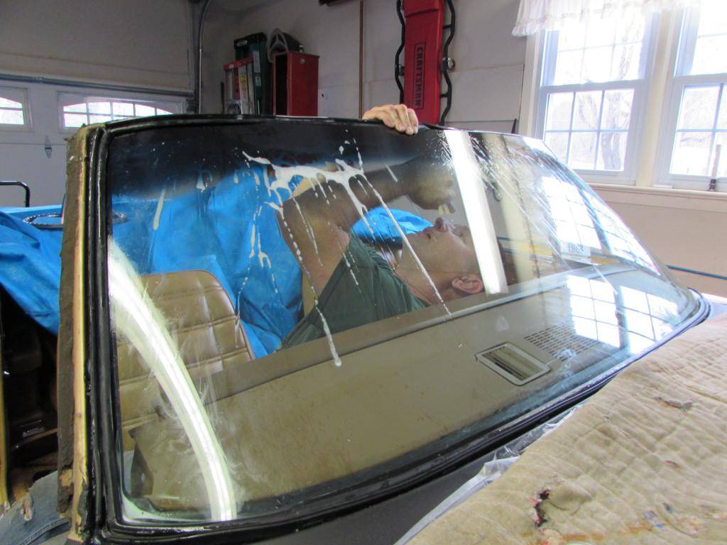

So lots of progress in the last couple of days. Windshield is back in with a new rubber gasket. This probably was the most stressful part of the resto for me. I was so worried that when I reinstalled the windshield, I was going to crack it. I'll do a separate thread on the entire windshield installation as this was my second one I have done. My charger being the first.

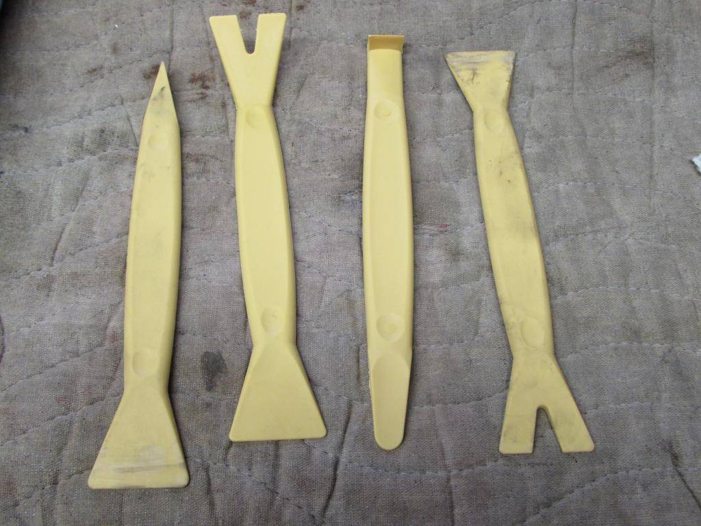

Tools used: (Key is to use a lot of windshield cleaner as a lubricant to slide the gasket over the glass.)

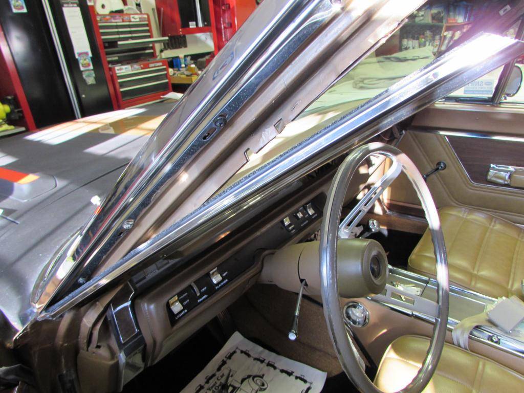

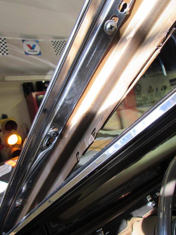

Yesterday, I had a PM from someone who was working on doing a windshield for a similar sister car, a 69 Coronet convertible. He was inquiring how the trim came off and I realized I had forgotten to post those pics. Be aware that the convertible trim is different than the hard top trim pieces. I have to say between my charger and Dad's GTX vert, the trim on the charger was a LOT easier as it required less stuff to remove. On the convertibles, you first needs to drop the top to expose the 7 screws that hold the two piece top windshield / header trim. Once that is removed, you can then move on to the side A pillar trim. This needs to have the A post weather stripping removed to reveal the 4 screws that holds the stainless bracket in place that holds the weather stripping. Once that is off, you will find another set of 4 screws that holds the trim for the A pillar windshield trim. Now that the A pillar trim is off, you can remove the lower two piece windshield trim with the special trim removal hook / tool. Installation is in the reverse order taking time to install all of the screws loose till all of the screws are in. Then you can go back and tighten them snug.
Pictures are from when I was installing the trim. Removal would be in the reverse order.
lower windshield trim
A pillar windshield trim installed, weather stripping stainless bracket being lined up.

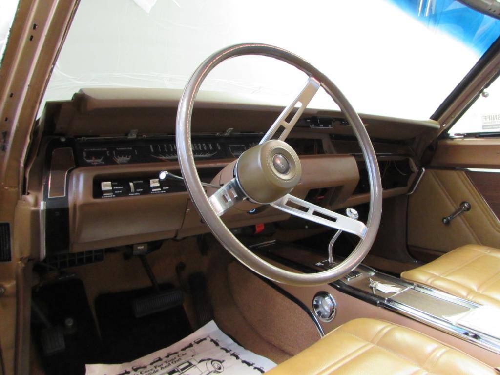

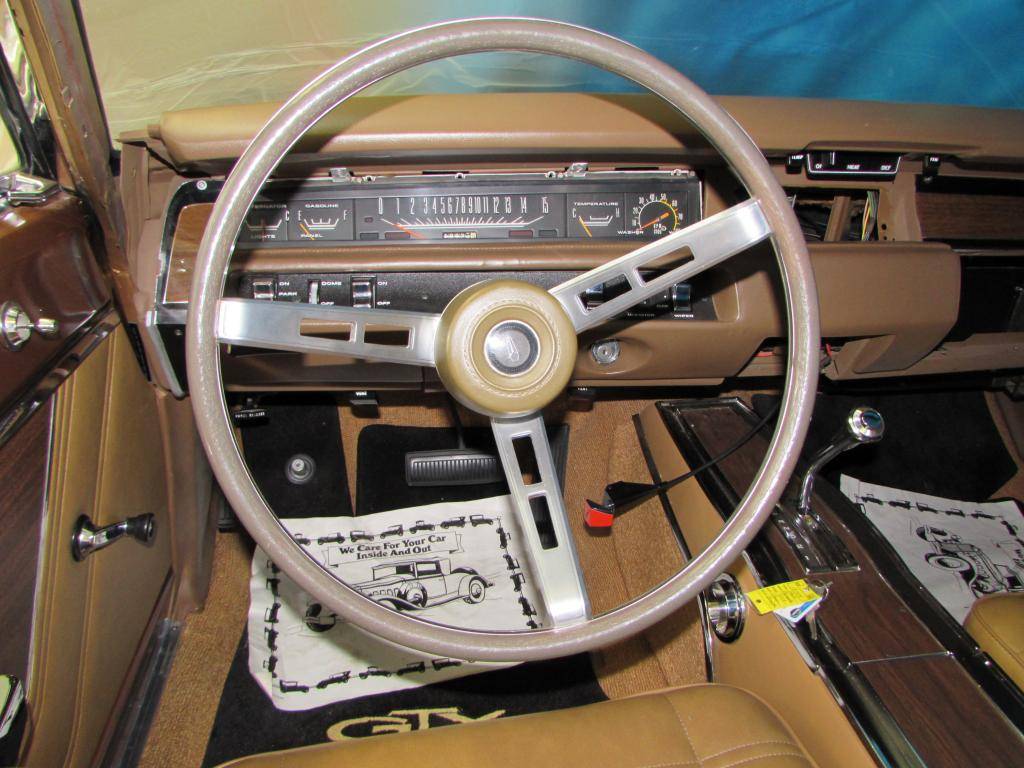

Got the interior all back in tonight and pulled the two lower dash end caps for the steel dash frame so I can send them out to get the chrome plated plastic done. Can anyone recommend a good vacuum plater? I know CV Vacuum platers went out and they did all the work on my charger years ago.

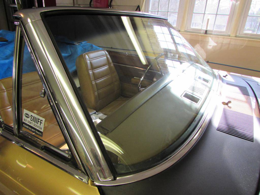

I really like that sticker, "sniff but don't touch", lol, If mine was like this one, i think i would have to know where to get one bud!! Great work and looking real good!.
Ron, its actually a static cling that we got at a car show from Hagerty. I've found its a nice place to put it as it does not obstruct your view through the windshield, and that window stays in place while the others we typically have rolled down at shows.
