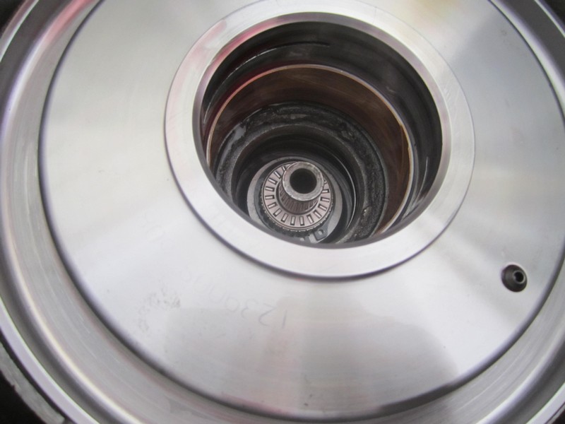

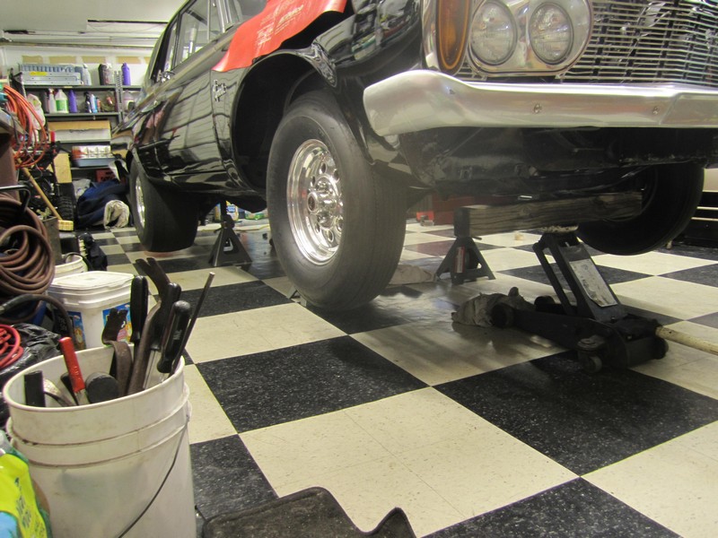

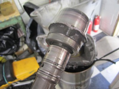

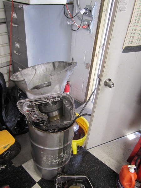

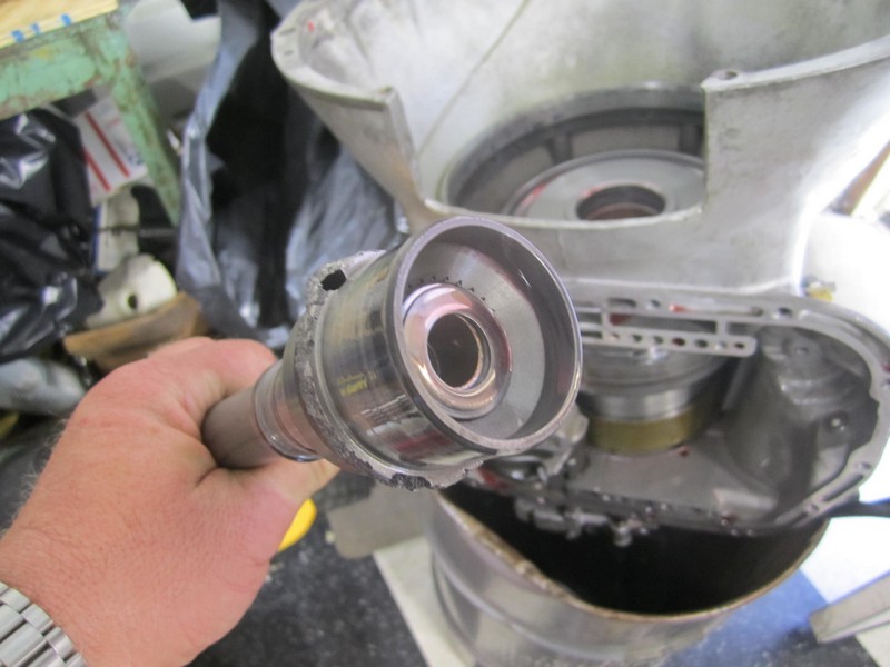

:angryfire: Went for a ride Tuesday night and had the chance to try WOT on a nice 2 lane concrete highway.At the top of 2nd just when I clicked high gear I heard and felt a major BOOM under my feet .Clicked the key off and watched out the rearview mirror expecting see all kinda parts trailing me.Rolled to the side of the road and looked under the car to see everything in place and nothing leaking so I restarted the engine and went through the gears,but nothing happened

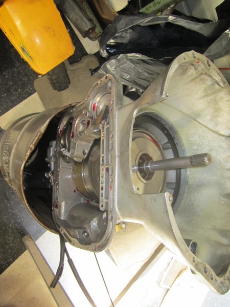

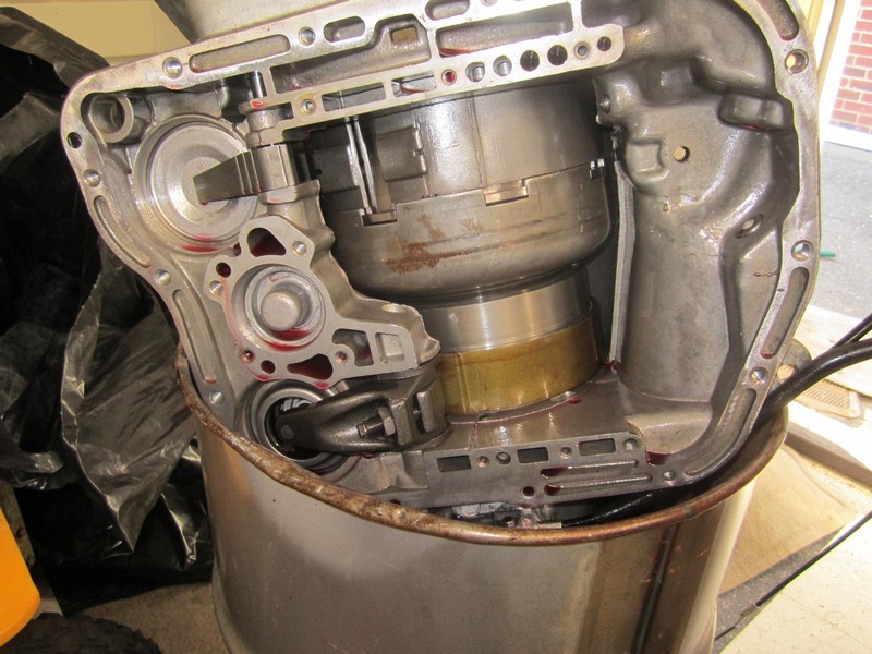

After I got a ride to get my flatbed,towed it back to my shop,put it up on jackstands and pulled the pan to find NOTHING but clean fluid
Pulled the unit out last night and called it a day.Went and pulled the trans apart last night and found a broken retainer hub on the back of the input shaft.
I see a new heavy duty maybe billit replacement in my future.
Who should I get a new one from?TCS,Cope,,,,,or???

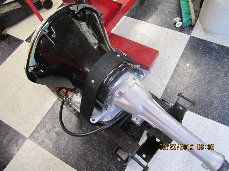

Sounds like you dodged a big bullet! Do you have shield on that? That could have been a lot worse! Can you say no foot? Especially with the power your putting out with a blown motor. A shield is a cheap safety part! Have you seen a 727 come apart and the damage it can do? Just a suggestion.
Your right Steve,I do have the CSR sheild and a billit steel front drum.Trans is mostly rollerized and I still like pushing buttons:icon_eyes:
