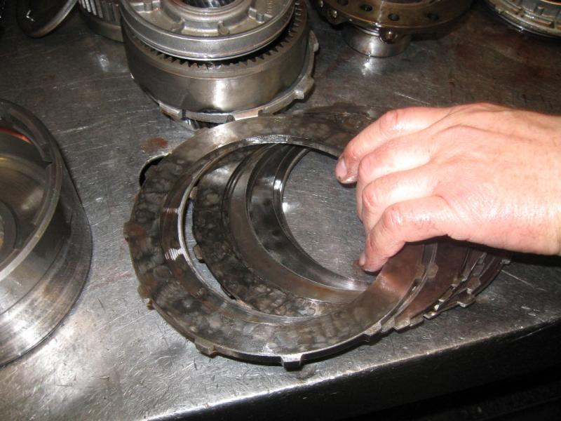

Hemi-Itis how much HP would you say your blown Hemi is putting out ?? I am just curious. I have always liked the basic 727 for a mild street/strip car as they have always held up great for me in 11 and 12 second drivers and so far I have had no problems with the one behind my 440/493 in my 63 running in the 10's but I dont race but a few times a year. But basically my 727 is mostly stock. I worked at a Dodge dealer for 24 years doing trannys along with all the other repairs and most were under warranty so I have a nice stash of factory 727 clutches and steels along with bands as thats all I ever use in mine is the factory clutches and steels. I use a bolt in overrunning clutch (rear sprag) and a reverse manual valve body and the Dynamic 9.5 converter. The rest is mostly stock parts. It has been in my 63 since 2006 and working great. But I plan to pull the trans sometime soon to change the stock drum since I dont have a low band apply valve body.

Ron,so far I have not gone much over 800 Hp in the street.Being traction limited my street jaunts start in the middle of 2nd 'tii I click high gear and have to lift due to stupit speed in the street.In your case,steel planets,billit drum,a good converter and a sheild or blsnket and you'll be fine:blob1:

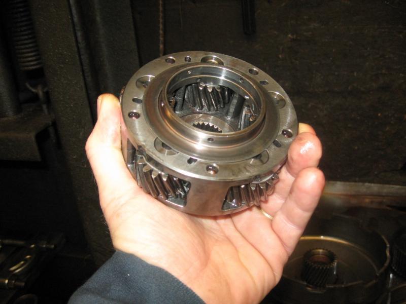

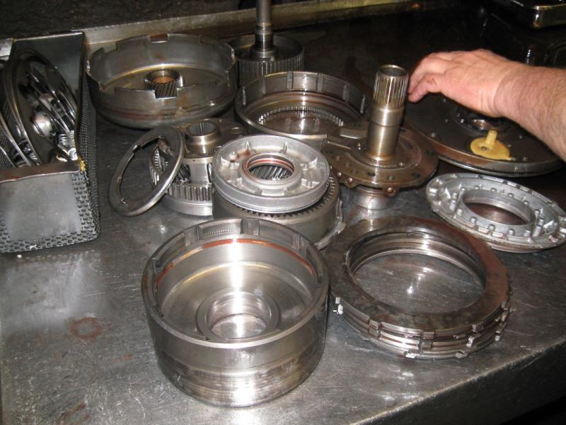

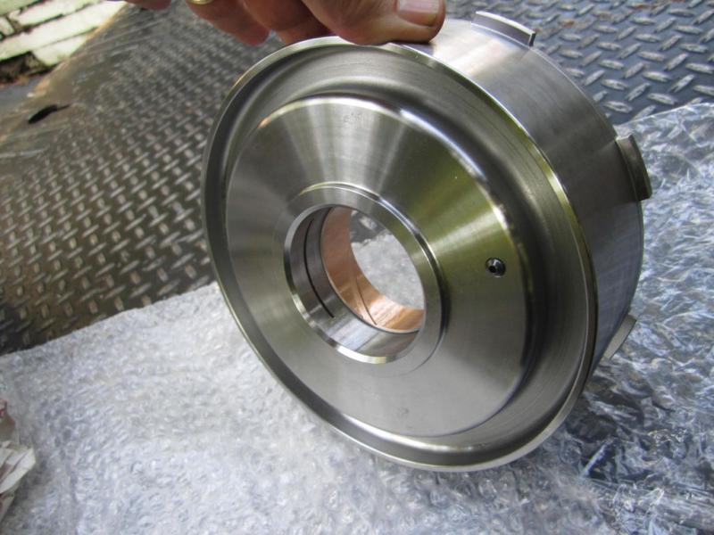

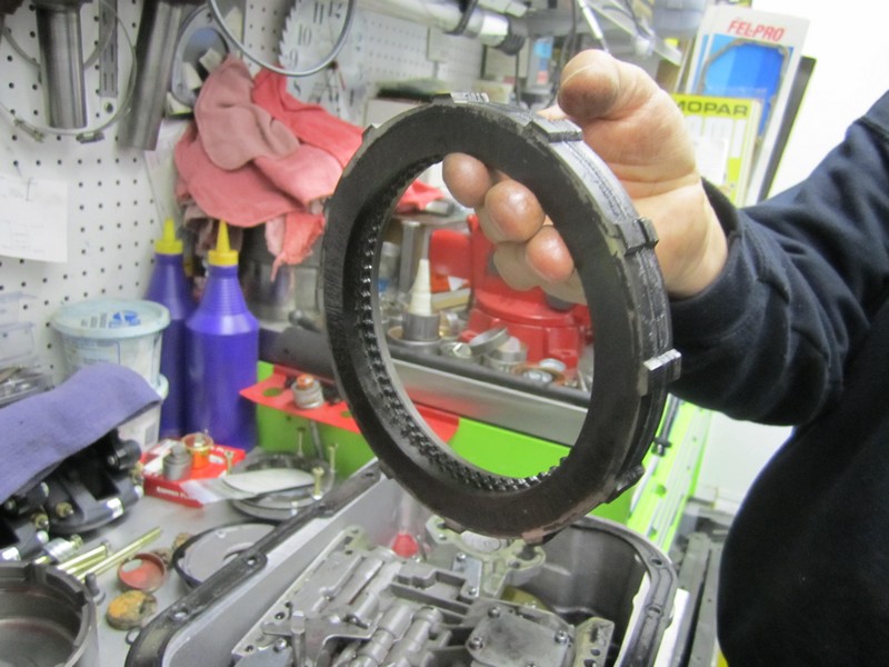

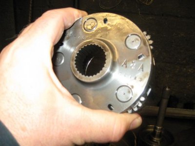

HemiItIs, those clutch steels, look like they got allot of heat into them, are they warped ??, who's internals are you using ?? who's bands, clutches etc. ??, what type/brand of input shaft ??, what type/brand front pump ??, that's a nice looken' drum, what brand is it ??, is it A&A like the planetary gears ??
are the pump gear & the input your running the TCS Products you showed in an earlier post ??

Bud,I opoligize for missing your post from back in May:blob1:I bought the drom,input shaft ans max lug gearset from Tcs in Canadia.The 5 pinion planet is an A&A part

cope did mine......same thing.....but no bang......tranny just went away.....lasted 5 years......A&A parts Cope uses.....just get a local tranny guy.....call A&A and order what he recommends.....great guy and sells all the trick heavy duty parts......thats what i did
