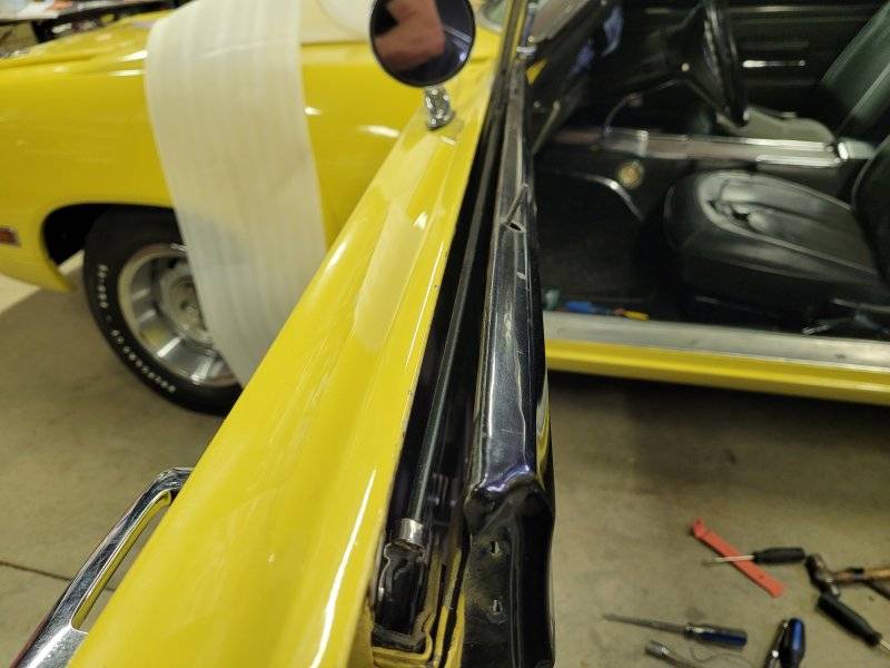

The jam nut with the screw in the hole. Loosen the nut and turn the screw CCW and you can lower the window top edge below the "sweeps".
Then you can remove the glass sweeps. I feed a wire around the clips and pull up. Glad I wasn't worried about the paint as these are fairly new and were a bugger to get to let go.

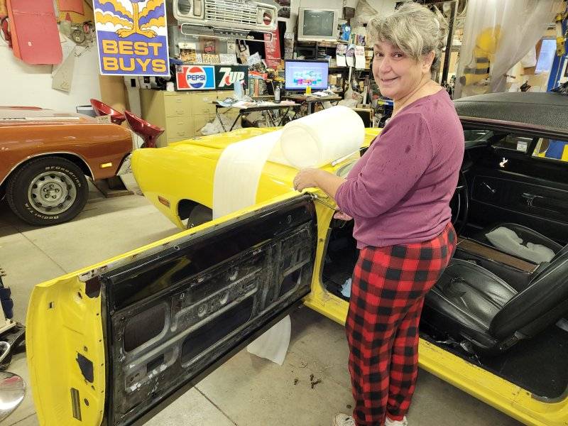

Door totally gutted. Was a nice MINT door.

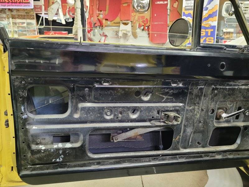

Doesn't look as good on this side.

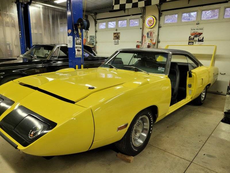

Think I might just drive it the 30 miles to the body shop vs loading in the trailer.

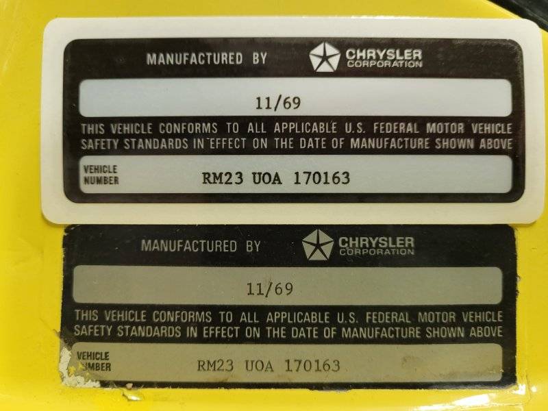

I already have the 32230 slider mylars and handle reinforce plates from Megaparts. I talked with Nigel this morning as my door shell and all the other seals and misc where supposed to be here Friday.. one of his skids from AMD has cleared the border and another is in transit... but he doesn't know which has my door in it. Got my VIN decal from ECS last Thursday... print not quite as sharp, but if they weren't side be each you'd never pick it up. Font heights spot on for the variations and correct O and 0 as the original.

Did you send them a picture to make sure it was printed right?
Everything photographed, measured and documented. Part of the process to get the sticker along with proving providence on your car (VIN tag, ownership, broadcast sheet).
I'm surprised that it isn't an exact replica, I thought ECS prided themselves on that. You're right, not quite as sharp, also it looks like bolder print and the serif isn't as pronounced.
Yep... I'll be contacting them tomorrow with a picture of them side by each to see if they want to up their game!
ECS rerunning my decal to move the 11/69 up a titch. Was told that's the best they have on fonts, as they don't have every variation covered. Told them Dave wouldn't be thrilled....
