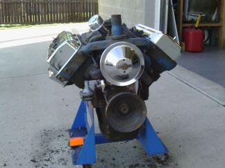

A rare 72 block? Nope. There were no rare ones in 72. Here's a table base I found. Suit yourself.
