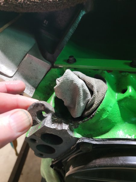

Please see attached picture.
We bought the block like this thinking we can get it fixed?!?!? Turns out to be a pain in the rear.
We would like to get some thoughts, ideas or directions on how to remedy this if at all possible.
Thank you in advance
It would cost so much to professionally repair, I would be looking for another block.
My bet is it'll never leak. Still has 2 bolts holding it. You could braze the piece back on without worry of cracking. I'd braze it then run a stud in the hole. As far as strength? I've seen wedge blocks with the inner bolt bosses to accept Hemi heads that were brazed on. As well as lifter bores being moved and brazed in. We are talking 800+ HP engines,

Thanks for the input guys.

Like Doug said..
That ^^ or some chamfers and some cast rods and you can put that ear back on with little trouble. That or machine a plate to fit behind the mounting flange, tap it and use longer bolts. Some give up toooo easy...
Just put sealer on the gasket, it won't leak. Thick cast iron flanges there.
I have repaired blocks with damage like that with no issues. As mentioned already run a stud in that hole after the repair and it will be fine.

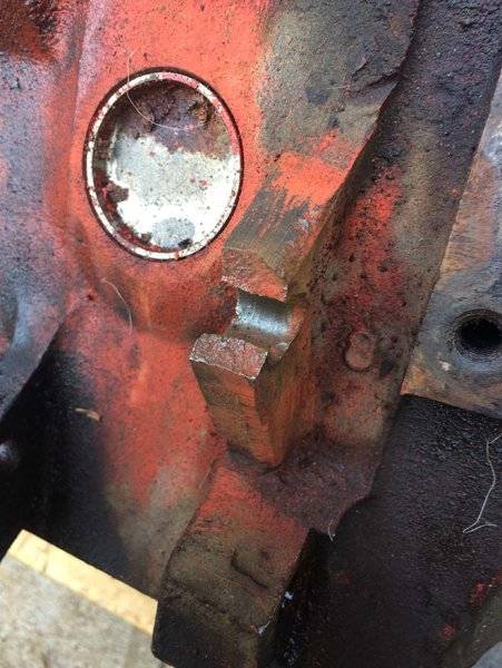

This is a repair using a Certanium 889 SP rods, a nickel alloy. No pre heat required. Should work fine in that area.

I would aviation sealer both sides of the gasket and run it.... betting it would be fine, worse case scenario is fixing it later. But in aviation sealer i trust...
