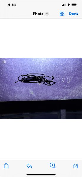

I’m looking at a 68 Coronet 500 with a W in the vin for the build location. I can’t seem to find where it was built. Any ideas? It’s on all 3 VINs: dash, core, and trunk rail.
WP23G8W……
Your body stamping is upside down and hard to read. If it is G8W then the assembly plant is St. Louis. The 8 is model year and the W is the first letter in the VIN.

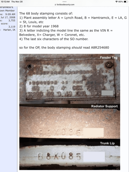

On a 68 the core support and trunk lip don't have the VIN.... They have the SO number..
I didn't mean to imply the VIN is on the rad support, as it isn't, but in 1968 the first letter of the VIN is, followed by the SO number.
