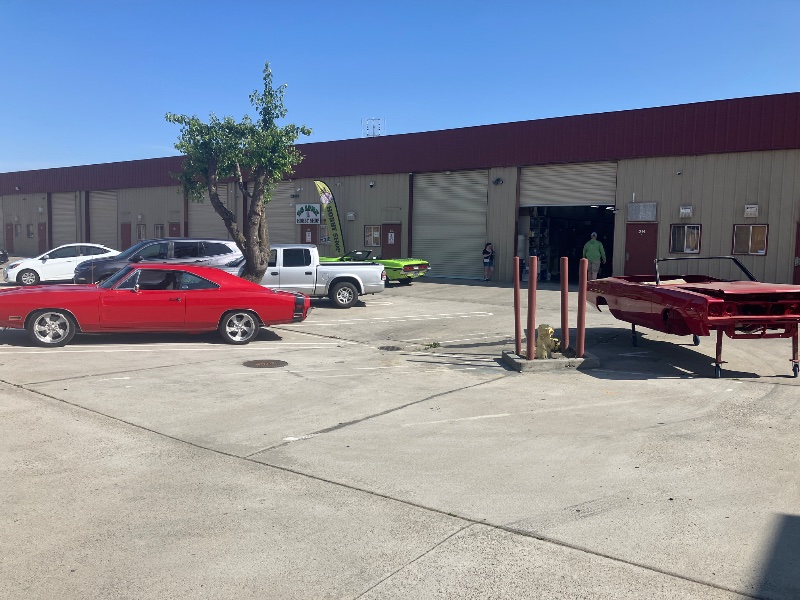

I would have liked to show you around. I try to get people to sit in the Charger to show off how great that Pistol Grip feels. My 10 year old nephew LOVES it.
It did look like a busy day for you guys though.

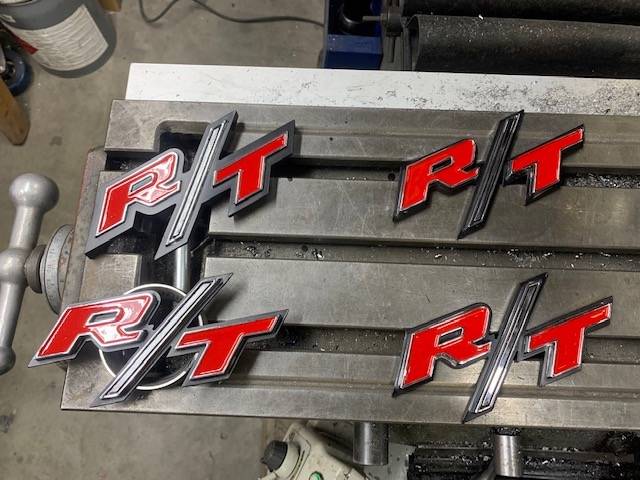

Hope to be color sanding soon but not yet... So I've been working on getting small parts ready.... My emblems are all NOS but I never cared for the orange/red paint Chrysler used to paint the emblems & really didn't like how it looked against the PP-1 red... So I stripped them & re-painted them... About a dozen times... I couldn't get the paint to lay down to my satisfaction, a little bubble, a little dark spot, What ever the case, I keep stepping & re-painting till I got what I wanted.... This time I'm pretty happy, still gotta run a razor blade around the chrome to remove a few bits of paint where it doesn't belong & one emblem has a minor ripple in the paint (I may strip & re-paint that one again) but over all I think they look pretty good...

There's a thin line between "hobby" and "obsession" sometimes.... :)
Guilty!! Always have been.... I want it how I want it & will keep trying till I get it how I want it.... Then when it's finished I'll drive the wheels off it...
Atta boy! :thumbsup:
Well, get on with it then! We are chomping at the bit to see this car completed!!! :D
