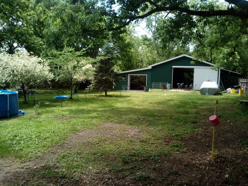

Unfortunately I can't even afford this but it'll get done.
I can relate, always my conundrum too...
I either have time & no $$$ or a few $$$'s saved
for the car especially/or a project for the house & no time,
never seemingly both...
this was supposed to be the start of my shop 42' x 28'
haven't touched it since, until ol' Pops quits RV-ing/traveling &
I get rid of the RV trailer, probably boat too, if I live that long...

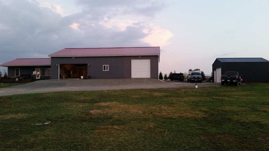

If you're open to suggestions I have a few for you. I am a contractor. Had my own business for 15yrs now. We build Alot of post frames and shops. First do radiant heat. There is no better heat for a shop, period. Second loose the wood burner, you can add that later. Hanging heaters are terribly inefficient, but really good at heating the air above your head. 55 degrees in a shop with a hanging heater is cold. 55 degrees in a shop with radiant heat is nice for working. The difference is your body heat is pulled out by walking on that cold slab of concrete. Radiant heat, warm floor, warm feet, or body if your working under the car. If you are determined not to do radiant, at least insulate under the concrete and run the lines. In a few years when you change
your mind, you can buy the boiler and manifolds. Here is a pic of my shop, I run radiant heat off a wood boiler. Keep it at 55 all winter. By the way, I like your shop design, looks great.
