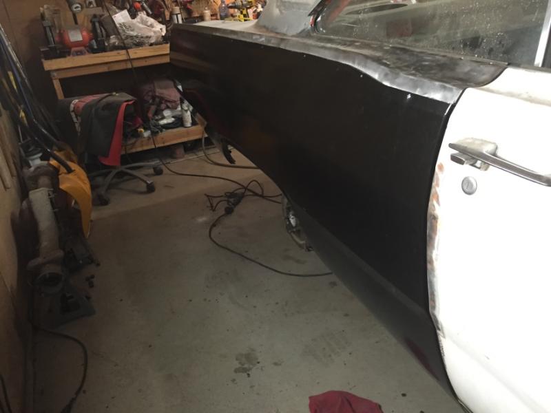

Obviously it's time to clean up, seal and paint the areas that were underneath. Not use to seeing whole solid metal around wheel houses, rockers and extensions. I may have entered The Twilight Zone! Up next, make my cut line on the new skin, fit in place, then cut along the established cut line on the new skin, into the old metal.

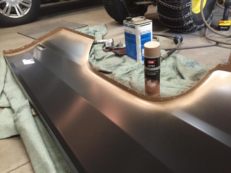

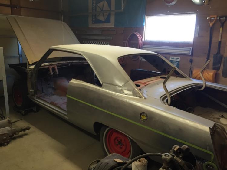

So the right quarter skin is trimmed down, drilled for spot welds, fitted and temporarily secured for me to make my cut line on the edge of the new metal vs. the old. I didn't get much time this weekend considering I had to watch Wisconsin beat Kentucky in the Final 4, as well as Easter today. Hopefully I can get the cut knocked out, final fitment and then weld up this week.
All in all the AMD panel is pretty decent. There is a few AMD fitment issues that will need to be tended to. I'll be addressing those on here in the near future. Also, I have quite a few more pic's I've been taking along the way. If anyone is interested, I will probably put out a step by step set of photo's & commentary of a quarter skin replacement, once the skin is all wrapped up.

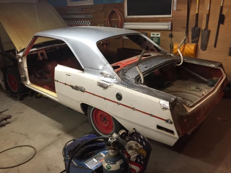

Well wayyyyy overdue for an update on the dart. I've been pegging away here and there.

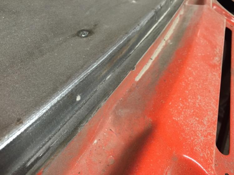

Newly replaced roof skin is stripped, and sealed. All welds cut down and leveled.
Also stripped a good chunk of the body. Drivers side has a couple dings and minor dents. Nothing a little skim coat won't cover right over. Passenger side is a different ball game.

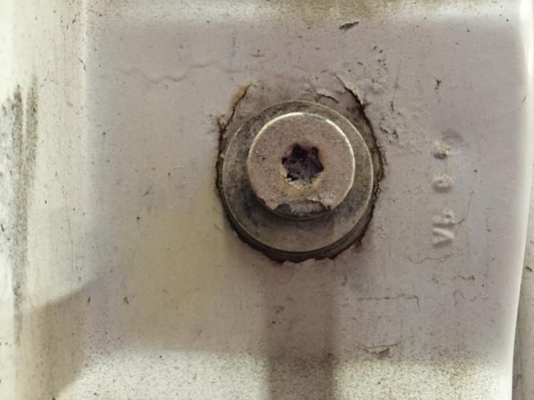

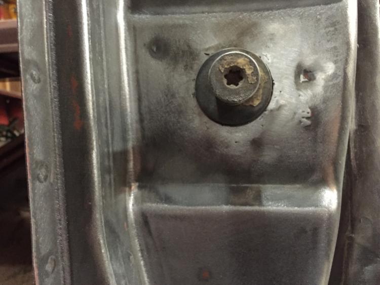

This must be an A-Body issue. 3rd one i've had with this issue. Both driver's and passenger side strikers in the jam were cracked around them pretty bad
Fixed

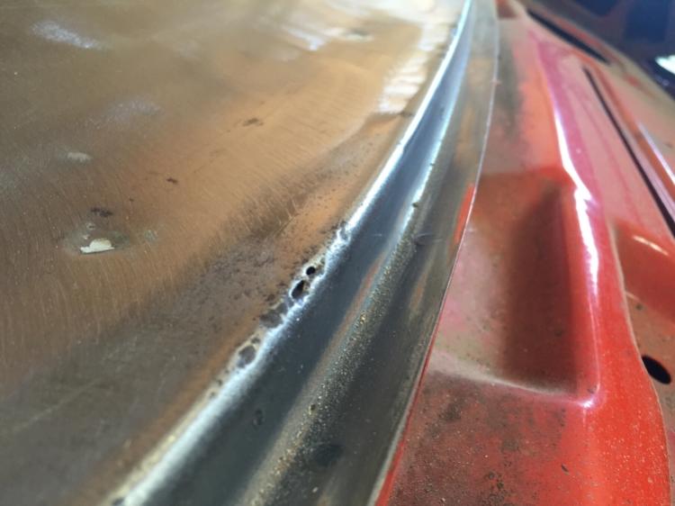

Also dealing with some rot on the upper lip of the deck filler at the rear window opening. Not to big of deal to hit hard with a wire wheel to peel back the thin/weak metal and weld in, along with the old vinyl top trim holes. About 8 spots opened up on the lip.
Welded

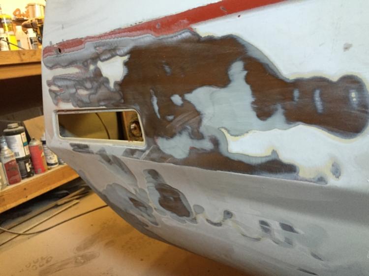

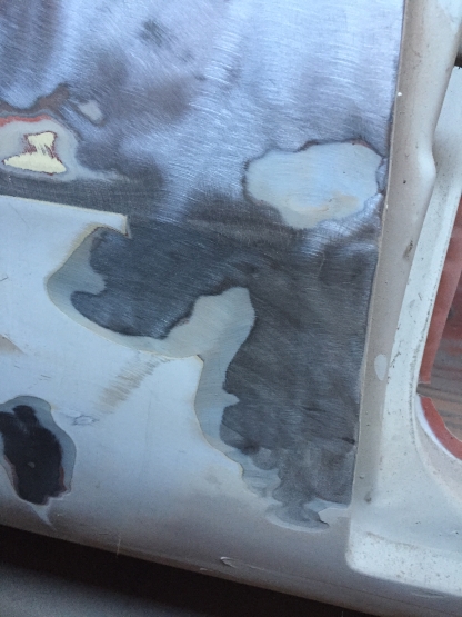

Everything was rolling along pretty good until the passenger quarter. Forest Gump must have been of referring to old cars when talking about "Box of chocolates"....Never know what you're gonna get. Anyways, kinda like opening a crappy x-mas gift, the passenger quarter was a bit sulking moment. Stripping it, literally about 1/2 the quarter was covered in mud, and not thin mud. The car had some serious damage up by the door, mid panel and back by the side marker light. No idea why someone wouldn't just do the right thing and waste all that time leveling filler, but oh well.
So I'm not one to half-*** things. I will be calling Jeff at 521 this week for the 4 speed hump, and it looks like i'll be ordering a new quarter skin as well. Already started drilling out the spotwelds for the quarter, just need to re-hang the door so I can use it for alignment for the skin.

I've seen A body cars there were barely 10 years old with the striker problem. And yeah, peoples likes to slam doors. Had my almost future niece start to slam our Durango rear hatch with all her might until I caught it and then just let it fall closed from about 6" up. She looked at me in disbelief lol.
