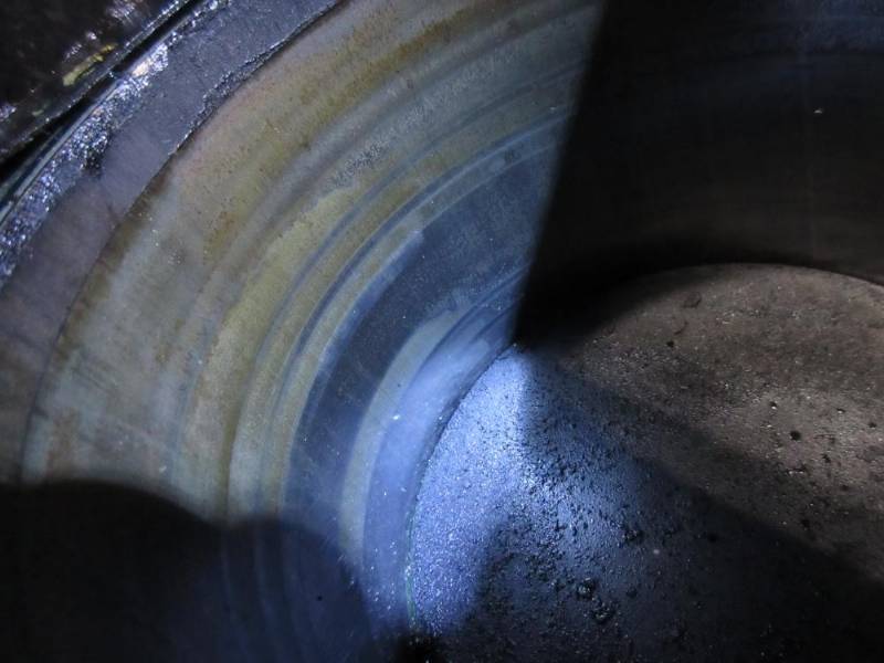

Got a 24" breaker bar. Much nicer to work with but the mail took forever. Anyway, head bolts are out and one head is off. The pistons appear to have plenty of carbon on them - I've never been into an engine this far before, but I'm guessing that's what it is. I was hoping to see some cross hatching on the cylinder walls, but none is apparent.

The other cylinders look like the one I posted a picture of. I don't see any damage. No cross hatching either though.

Cylinders have a noticeable ridge at the top. I saw Lunar Outlaw on YouTube check for it, and it sounds like a bad thing, and that's as much as I know about it so far.

So, how bad is this ridge at the top of the cylinder? It seems like that would be a problem if switching to a piston that is higher in the hole, or zero deck.
