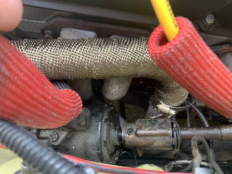

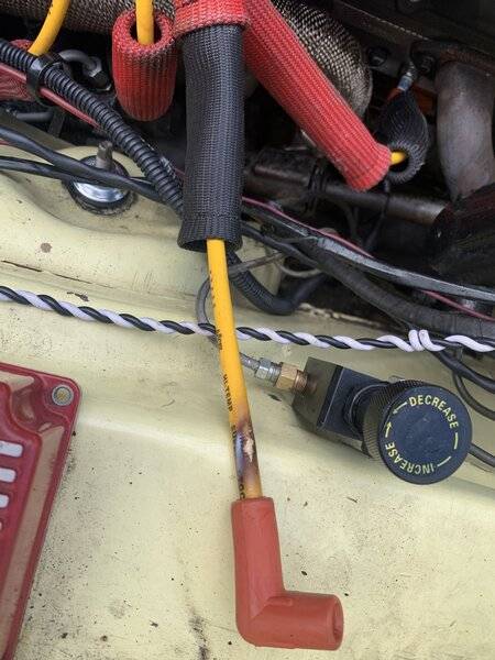

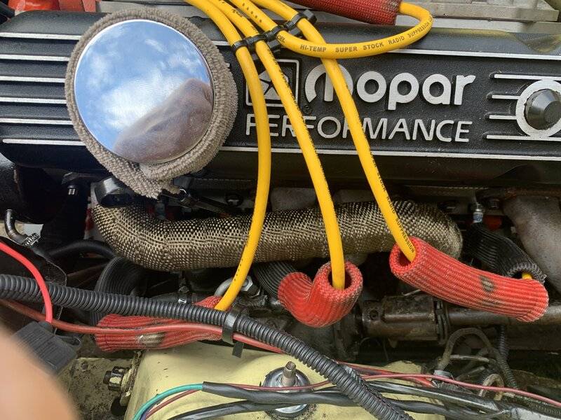

So I have burned the #5 plug wire a couple times now. The first time I thought it was routed too tight to the headers, so I did another set looser and boom still smoked one.
I'm using a slide on plug wire protector but it doesn't seem to be shielding very well. Either JEGS or summit brand. The second time I used 2 just to be sure I was good....I also wrapped the top header tube with DEI titanium exhaust wrap.
the heads are a edelbrock victors so they do have a funky raised profile, and unknown brand (think they're hookers but not sure) long tube headers from the back of the shop but they fit well and don't leak.
the boots are not burning it's the plug wire. Even the slip on sleeve is still good. Shows signs of heat but still good
Also pics or it didn't happen....
49305B73-97FD-4AF1-8511-831F13C78AE9.jpeg E29292B6-9DA7-4F96-9F43-5743960DA73D.jpeg CB64D284-2960-4588-8ED0-949ABBD42CB4.jpeg
G.M used mettle shields for 4 cylinder 1.8 see if you can find that style boot shields.
I route mine down and around the front, as opposed to up and over. In your situation the #5 could hang straight down and not be as close to the pipe...but, I make my own as it does require them to be a little longer.
I used a generic brand heat sleeve and mine push against my TTI header on my 383. No burns or melting. Wish I still had the box so I could tell you the brand.
I did the build your own plug wires on these. There " universal fit " no issues there if I have to make a new set longer
It's weird that the boot protectors seem fine. But the wire is buggered, I was thinking of switching to some of them being straight plug boot on a couple of them.
I do not have the oem heat shields that a couple of the cylinders have.

After watching the video, sounds and looks like you have a exhaust leak. Maybe the leak is blowing right on that spot?
I can see how it looks like an exhaust leak, my rookie ears don't hear the tick tick like a single leak but I'll get some paper out after work and check for sure. all that smoke is from the wires and boots 100%, I'll get a different video tomorrow.
Exhaust leak confirmed on the collector flange.
I have a new wire in place and have it covered with a DEI wire sleeve and a boot protectors.
