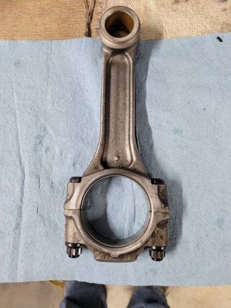

I thought oem was 1040 and aftermarket i- beam was 5140?OEM rods are made from 5140 material. Sure you can go in and lighten them, but the material is not nears as strong as 4340, so you are actually weakening them by doing so.
Plus the aftermarket rods have a 7/16" bolt over the OEM, but they are also a cap screw design which is superior, and doweled.
For what it cost to build an engine today using old OEM rods is like riding around with the pin pulled out of a grenade. The $720 investment in new rods is cheap insurance.
Tom
IIRC, Direct Connection had some stock appearing rods that were high strength but don't remember what the number was. Thinking it was even higher than what you quoted for the aftermarket I beamI thought oem was 1040 and aftermarket i- beam was 5140?
Either 4140 or 4340 Chrome steel. 5140 is chrome steel with no moly. It's my understanding that moly is added for machine ability. I don't think moly adds strength. Pretty sure there were no chrome steels used for production pieces. Wish I had more detailed info on these steels.IIRC, Direct Connection had some stock appearing rods that were high strength but don't remember what the number was. Thinking it was even higher than what you quoted for the aftermarket I beam
Seems like most, if not all, aftermarket rods are Chinese. All i-beam aftermarket rods I've seen are 5140 Chinese. Why 5140 i don't know. Apparently cheaper than 4340. I've read were 5140 is used a lot in ship building. For what I do 5140 is good enough or maybe better than factory steel. Keep in mind that back in that era cast rods were still being used by some manufacturers. I think i- beam versus h- beam might be a good discussion.Thank, I've corrected it in the previous post. I so rarely deal with the OEM stuff I had forgot what it was. I used to sell some 5140 rods that PEP carried, but those are long gone.
Tom
Cast rods as in cast iron?Seems like most, if not all, aftermarket rods are Chinese. All i-beam aftermarket rods I've seen are 5140 Chinese. Why 5140 i don't know. Apparently cheaper than 4340. I've read were 5140 is used a lot in ship building. For what I do 5140 is good enough or maybe better than factory steel. Keep in mind that back in that era cast rods were still being used by some manufacturers. I think i- beam versus h- beam might be a good discussion.
YesCast rods as in cast iron?
You can get light weight pins in a 1.094 and cutting the stock ones down to 3" will bring them from 225 to 190ish.I haven't read this whole thread, but.....
If lightness is a concern (and it should be) I would never build another bbm without using a .990 bbc pin
From what I have read, the Sixpack rods are 60-70 grams heavier than an LY rod, and considered heavy. The chevy pins are 75 grams less than a 440 pin. Light pistons/pins automatically make ANY rod in the engine effectively stronger.
The piston/pin for my stroker 440 is 400 grams lighter than my maxwedge pistons that I took out.
Boom! please pass the dust pan!In my old 67 Charger I used to hit 7000rpms regularly with the stock forged crank and six-pack rods. No issues. Why spend money that you don't have to?
But the boom never happened and the dust pan wasn't needed.Boom! please pass the dust pan!
