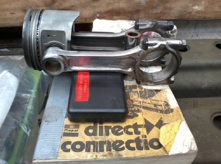

Talking of rods and bolts and all things 426 engine.
How's about a hemi rod, good or bad?
(The six-pack rod is almost identical to the hemi rod except for the bolts.)
So Weslake Engineering got Mother Mopar to make some hemi/440 length rods in 1969.
The front rod is outta my 426 hemi.(6.860)
The rod on the piston is outta the Weslake 426 Nascar engine. (6.768)
Back then they didn't have any options and they still ran over 200mph with them.
The weirdest thing is they are factory press fit how bizarre indeed.:fool:
I guess the six-pack rod had not been invented in 1969, so they made a special hemi 440/426 rod!?
I guess the six-pack rod had not been invented in 1969!?
You are correct. The 69 Sixpack motors used LY rods. Not till 1970 did the Sixpack engines get Sixpack rods.
And .100 longer rod is hardly the same except for bolts.
And I'm pretty sure the Nascar engines used Carillo rods even way back then......
Both rods in the picture are Hemi rods!
The front one is a longer hemi rod.
The one attached to the piston is also a Hemi rod, special made at 440/426 length for Weslake Engineering in 1969.
Both have factory 7/16 rod bolts and are the same apart from one is .100 shorter for a wedge engine.
