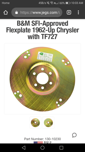

There are 2 different factory converter bolt patterns. Buy a B&M or aftermarket flex plate. Or if you know a good machinist have them redrill it.

redrill to make it look like this one.
The 10417 is an 11", same as the 383HP would have come with. If it wasn't originally a HP it would have come with a 12" converter with a different flex plate.
The 10417 is a 10" I think but I need 11 1/8 bolt pattern.
As you can see from the B&M picture, there are 2 different bolt circle diameters AND the larger size bolt holes for the Hemi (or some aftermarket) 7/16 bolts. The B&M plate pictured covers them all. Beware of the 1 offset lug too & which side of the plate goes toward the block.
