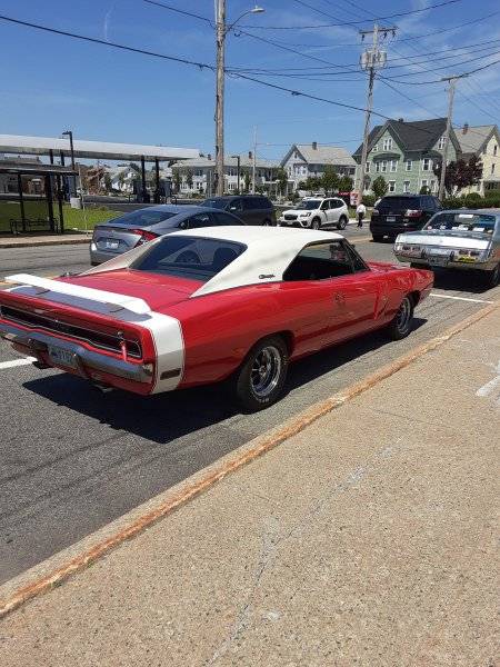

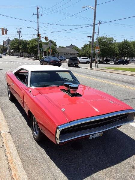

My friend has 73 C body seats in his 70 Charger R/T. Power drivers seat too.
