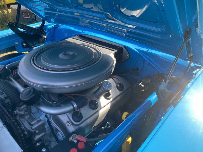

Beautiful paint, nice engine compartment, liking the "stock" unmolested look, especially that roadrunner "air grabber" air cleaner.

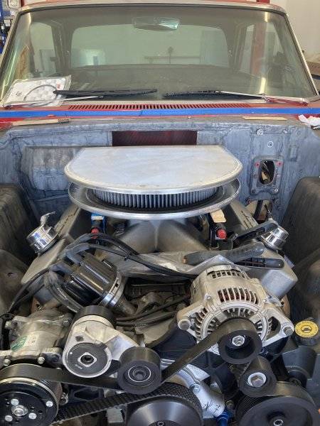

The air cleaner is a custom fab unit I'm doing. Going old school NASCAR cowl induction so I can not put a hole in the hood.

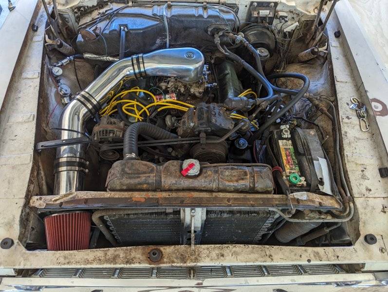

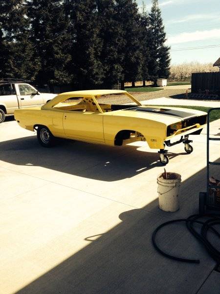

So something like Ram/cowl induction? Sort of like the on the 68? 69? Plymouth roadrunner?
That reminds me...
I considered what I had done to be butchered, and not "original" or a complete pure Honda "ricer" but I wasn't about to cut a hole in the hood to complete the air intake ducting, besides, a big lead sled cruiser doesn't really "look right" with a big ram cowl induction system sticking out of the hood, my Other A/B body guys have that covered!
but here's what I had done with the induction system on my end, didn't like how the engine was sucking in hot air from the engine compartment, just was my pet peeve.
And the Dodge I was working on being a Forward look/C body car, there were not much parts or kits that was being supported a "cold air" induction kit, so I had fabbed up my own.
The ducting could have been just regular corrugated flexible tubing, but I went with smooth 5 inch diameter aluminum ducting to preserve the air flow without being interrupted, the smooth tubing will be less turbulent than the corrugated tubing.
I was looking for a bit of a sleeper intake style, with the filter hiding behind the grille to give it that, "it's not stock" kind of look.
But ironically it's as stock as can be. Lol.
Apologies for the long post, just reminded me of when you are also fabbing up an intake system as well.
And yes, the zip ties being supports for the ducting needs to change, but this will do until I can secure the ducting without being too solid to the rest of the engine/carburetor.
Similar to this. To see more of what I'm doing, go to the members rides/restorations section and check out "updating the super street mopar".

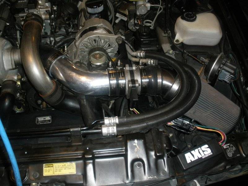

That's a really cool, creative modern take on a vintage cold air intake. I wonder how it affects performance, any guesses? It's intriguing to me because a 1970 Charger hood is too beautiful to be cut up to add a scoop and you're really limited to how big of an air filter you can install. I don't even think I can put in a 1" carb spacer with my existing 3" air filter. What part is that unit attaching to the carb? Are the tubes 3"? Does that fit a typical carb like an Edelbrock Performer 4-barrel? Thanks.
I fabricated my own CAI for my '86 GN because the aftermarket ones were way overpriced considering you could buy the tubes and silicone connectors yourself, and mine also kept a 3" diameter right up to the turbo, all the aftermarket ones were only 2.5" from the air filter up. It was nice to get rid of that air box and accordion-like intake tube.
The performance "increases" changing over from accordion tubing to smooth tubing may be a small to little boost.
but the ones that's at the race track strives to make even an improvement no matter how little impact it has.
I strive for those little bit of performance boosts, it's actually fun to rack your brain to see what can be done, and potentially "outsmart the engineers"
Honestly I don't know how anybody questions the typical "Cold air intake kits" sold by K&N.
They supply you with plastic accordion tubing and probably a bit less restrictive air filter for about a cheaper price range of $200.
Even on some other vehicles, the "kits" can run as high as $900! Or $1200!

I'll link the tubing/parts/carburetor "hat" that's sitting on top of the carburetor.
TLDR: The carburetor air cleaner is a mounting size of 5 1/8
And yes, if I had to guess for performance increases, theoretically, the long tubing provides low end torque while a regular short tubing or otherwise stock air cleaner intake setup will boost top end RPM performance.
IMO, big lead sled cruisers need the low end torque, not to be used as much on the straight away. Sometimes.
I did some extensive research as I wasn't about to cut a hole in the radiator core support for the ducting to not work.
The 4 inch ducting is a bit small on a big block Chrysler 361, from calculations I had run a few years back, I needed a ducting size of around 5 inches or so to fully optimize the free breathing of the intake tract.
I'd assume the inadequate ducting size can be compensated somewhat using a different step up rod/springs combo.
Apologies, some additional notes: if the ducting size is inadequate for the engine in question.
You'd have a rich A/F mix, not enough air too much fuel.
This was mounted on top of a Carter AVS, so a Edelbrock will work with a mounting flange size of 5 1/8.
Below are the links where I bought the ducting from, lo and behold Amazon!
The 2 45* 4 inch elbows.

The performance "increases" changing over from accordion tubing to smooth tubing may be negligible, but the ones that's at the race track strives to make even an improvement no matter how little impact it has.

Awesome, thank you, I appreciate the info! I can definitely say turfing the original GN airbox and fabricating my own CAI, along with the necessary AXiS interface and chip burned for 93 octane, made a significant and noticeable performance improvement over stock. Ironically, I also bought all my stainless tubing, elbows and 9" K & N cone filter on Amazon.ca.
I think for a 1970 Charger, routing 4" or 5" tubing along the passenger side inside fender might be a challenge, the washer bottle would likely need to be relocated. But I really dig what you've come up with.

For sure, give that early 80's ECU a flash tune then let er' rip! Or is that an OBD I? A bit harder to tune then.
The ducting could also be routed a bit lower to the side of the fender. Somewhere around where the torsion bars sit?
Thanks i appreciate it.
GN's are actually very tuneable. It's OBD1, the protocol was called ALDL. I installed an ALDL Bluetooth adapter inside the center console and there are 2 apps on my Android phone to monitor and log everything, ALDLdroid is the main one and Torque Pro. Back in the day, guys would buy an expensive tool called the Scanmaster, but with the Bluetooth adapter, you can do everything and more with your cellphone.
Most CAI's are positioned like mine, though some indeed route downward with a hole and ducting cut in the black plastic spoiler beneath the bumper, but then you have a bit of work removing the charcoal canister and other stuff to get the ducting down there. I was fine with removing parts but not cutting anything up.
