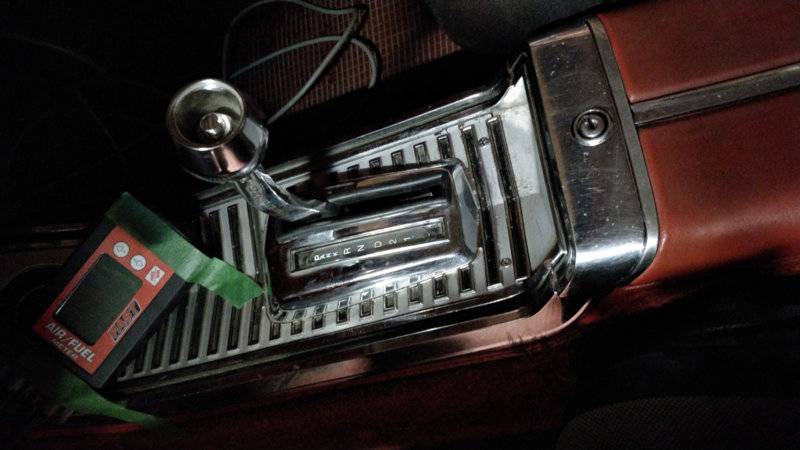

I didn't do the conversion on my 64, but it has an aftermarket ratchet shifter that works in the stock console slot. So that's another option.
Mr Gasket Pro Matic. It looks and works just like the one in this video.
Would you mind sharing a pic of it with me please. I may end up going that route. I don’t like how the stock shifter can be shifted so easily out of Park when without keys, I know I’ll nvee have an issue but you never know when your at a car show. I have seen people get into other peoples cars when they walked away.
Here's a pic.
