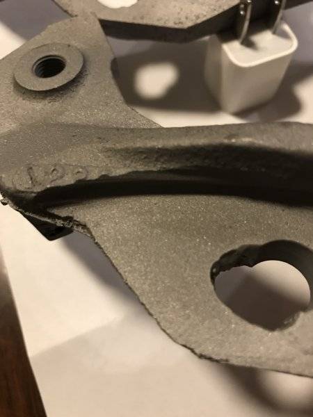

With the front end being apart on my 69 Bee, front disk brake car, I discovered this oddity with the caliper bracket, looks like the mounting holes have been torched open to make bigger.
Any body have ideas or know where I can get just these brackets please, or do I need to purchase a new “something” kit? Brackets come with the spindle?
Not sure I want to keep using these f’up’d brackets. Brakes seemed to work fine for the last 12 years since I’ve had the car.

On the one adapter I just now noticed partial numbers. Now I’m wondering if these were jerry rigged to fit since it looks like a lot of grinding has been done. Didn’t even notice before until questions started being asked.
You may have drum brake spindles, check into it. My conversion kit came with spindles that match the brackets.
Maybe those are early 70's NewYorker adapters, (maybe all C bodies, or trucks, I don't know). I've got a couple sets of these in my stash, pin type, big rotor, but the mounting holes are about 1/4" closer together than the holes on my B body spindles so they don't bolt up. But that's an interesting mod to make them fit. Not so sure I'd try that though, torches aren't calibrated.

You need 73-74 A-Body or 73-74 E-Body spindles to use those caliper brackets.

Okay. Does the 73-74 B body use a different bolt spacing than those you mentioned for the caliper bracket? So maybe we need the measurement or part number from the OP's spindle to know what adapter he might need?
The info I posted came from Mopar Action Disco-Tech front disc brake conversion. I would they no because they would have said those would be another option. MO I did that conversion in 2002 using the parts list published .
Those do like a "I made it fit". I've done that myself many times, but NEVER on brakes. LOL
From this view, I’m not seeing a PN. Let me guess, it’s on the front?! But I’m also holding up the adapter for fitment idea.

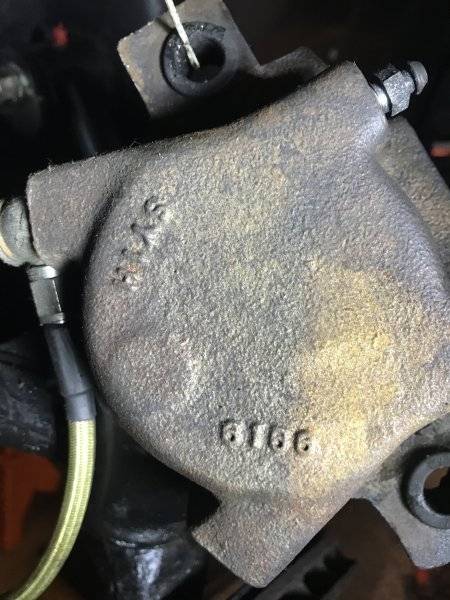

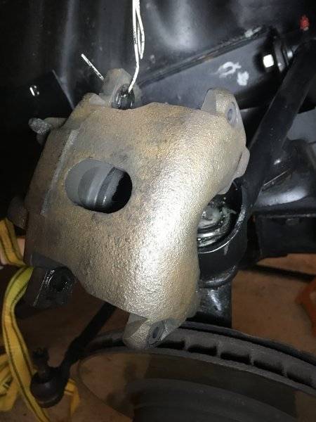

Here’s the single piston caliper
Shame they didn't go to a machine shop to do it. Picture is the 11.75" caliper bracket.
Sounds like the big rotor, and the adapters you will probably need, if you want to keep the pin calipers and big rotors, is the difficult to find expensive ones. I've seen prices $250-$450 a pair. I do think somebody might be making them, but expensive too.
I’m reading the Mopar Action Disc Tech article, and my adapters measure, center of hole to center of hole, approximately 3.125”. The 3.5” puts it well outside hole center.
