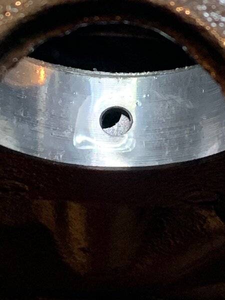

Got my 318 back from the machine shop where they installed new cam bearings. I noticed the center oil hole looks not lined up. Do you think it will be OK?

Which cam journal? #2 and #4 need the hole to the rocker arms aligned along with the feed from the mains.
The pictured bearing installation is pretty poor. I would have the machine shop re-install it. If you look, besides the holes not being aligned that well, the bearing was not installed to the same depth of the hole.
It will work as-is as long as the rocker arm feed holes are not blocked, but I expect better quality from the machine shop I use.
Sorry to rant on about quality, but why pay for a service if it is done half-assed.
That would just bother me forever knowing for minimal effort it could be right.

It's number 3
Have them take it out and install a new bearing even if you have to buy a whole set. The shoddy install job blocks the oil supply by over half. Not ok in my book.
It’s definitely shoddy work and it’s definitely restricting some oil, but there’s so much oil being fed to the cam bearings it’s in no way detrimental to the engine. If in doubt, pull a cam out and put a drill on the oil pump and watch it go!

I'm building the engine, so I'll watch for that when I prime the oil pump...

If the block is grooved the oil will find the hole, that being said oil holes in grooved blocks should be installed with the cam bearing oil hole down towards the pan. The reason is valve spring pressure pushes the cam down creating more clearance on the top of the cam. If the oil hole is up it will have more clearance and drop oil pressure. Might seem insignificant but it will make a difference in oil pressure.

In small block Mopars, having the #2 and #4 cam journals grooved is not that uncommon.
Common issue. Just open up the hole with a long drill bit or even small file and a few minutes of work. Zero reason to remove the bearing.

Well...... sort of.
Those holes not lining up is not really going to be where the “restriction” is.
The restriction is the clearance between the cam and the bearing....... which will be way less area than the size of that hole.
