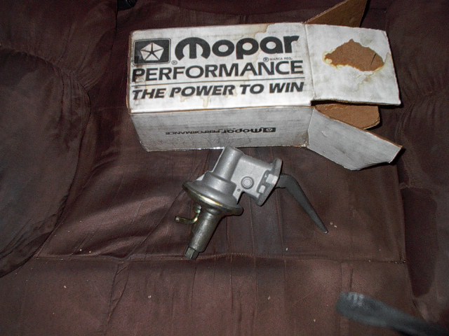

Bought this fuel pump for my hemi build and it will not fit/work. It is stamped on the box P4529594 AND stamped the same on the pump...BUT....when researching that part number...no pump even comes close to it. So I'm hoping someone out there seen one like this.....Thanks in advance... IM000891.JPG
oh...it's new and for sale....lol

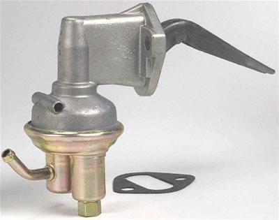

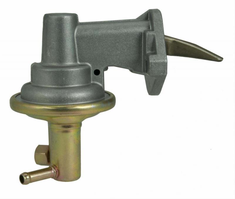

Nope that is not a 594 BB pump. Should have a short arm. I'm thinking that it is a mis-marked /6 pump. Arm doesn't look long enough for a small block pump.
Khrslerkid....been there...number same but look at the picture
Moparmark....looked at the 6 and no go also
Hemi rebel...same number BUT...BUT...no picture...also saw that before posting
Thanks for the effort
Gee Wally, that is a long one! Small Block
Sixes, BB, RBs, Hemis are short.

exactly the same except your tube has a full stiffee while mine is at half mast,,,,,I realy got hosed on this one. Thanks for finding it
Find the amc/jeep guys. Hey, on the bright side you can advertise it as a new in the box discontinued part.
