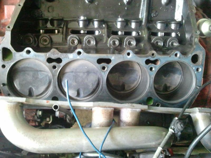

Can anyone tell if these pistons are stock? The previous owner changed some things on the car to race it (4 speed, Dana 60 with 410's, hd leafs in back) and started me wondering if he bored out the cylinders and replaced the pistons. I do know the 383 engine was rebuilt some time in the past. I had the heads off last year but it never dawned on me to measure to see if the cylinders were bored. I did take a pic while the head was off though. Can anyone tell if these are stock pistons by this pic?

Thanks for the pic. Good to know. Can anyone tell anything from seeing the tops? What brand or type these possibly are and if these are made in certain sizes(as in was my 383 possibly bored over)? I know I am stretching for info with this simple pic. Just curious. Not worth pulling the head again to measure it or look for markings but would be nice to know.
looks like a dome w/ a trough to me
What is the point of having these type? I can assume more power but any other reason? Trying to learn. I haven't done much deep engine work besides pulling heads.
I am surprised the previous owner did not swap for a 440 with all the work he did to race this.

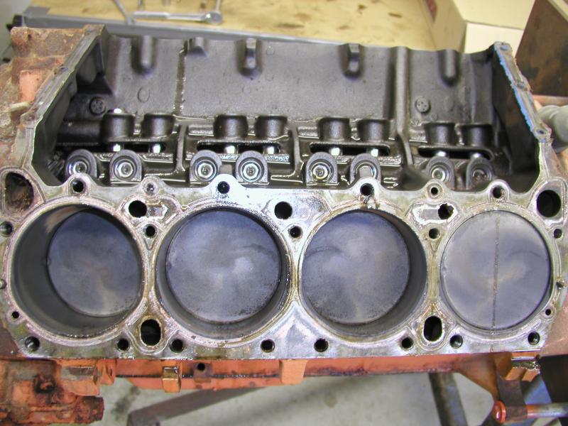

As pointed out above - NOT STOCK. If those are in a 383 then you have at least 11:1 compression with an open chamber head; more if in a 440. And you do not want to run those on the street. The other engine with flat tops is what you want.

like what Meep said: it's to raise the compression ratio w/o swapping the heads, the dome on the piston is meant to take up the room in the combustion chamber, these look to be some higher domed pistons
with these pistons in this engine, later on if you want to swap to a set of closed chambered heads, you don't be able to w/o swapping out the pistons, sure, it might raise the cr now, but it'll bite you in the *** later on in life
Why should I not use these on the streets?
Seax, are you saying the higher cr is what will cause me issues down the road or just trying to swap the heads with those pistons in it? Why would I want to go to a closed head vs open? I have no plans on changing anything unless I need to.
Way too much compression for the available pump gas in the older engines. There is a minimum octane required for given compression ratio so to play it safe, and without going into a lot of detail, you want to end up with about 9.5:1 for a street engine.

Anything above 9.75:1 on a standard wedge head (non-aluminum) and you are risking detonation with 93 octane. It isn't worth it, drop the compression down as you don't have a prayer at 11:1 compression unless you are running 110+ octane with iron cylinder heads. 9.25-9.5:1 (with 84-88cc heads) are great, street friendly compression ratios with or without the quench effect. In the old racers glory days, bumping the compression ratio was a positive for power as no timing adjustments were necessary as the standard pump 100+ octane fuel was very capable at 10.5:1. With modern fuel/ethanol blend you are lucky to have 9.5:1 and keep a 36* total timing. Local ford guru engine builder states you want no more than 9.75:1 and 32* total timing with pump fuel for the maximum amount of power. Detonation is what kills engines, when going forced induction you see this ten fold. It is better to run rich with safe timing, than be running lean with timing on the limit. Your compression ratio with those pistons will be well above what even your 96 octane blend could handle (more than likely) and if not, you would be near the verge of detonation every time you got into the throttle. Trust us, it isn't worth it.

those look like the old TRW 12:1's. i ran them once, back in the day. very heavy power robbers. the slot is to clear the spark plug, which ought to tell you something. the plug is heavily shrouded creating poor flame travel and a power loss. as said there is no way those pistons will run on pump gas. if i remember correctly the domes are solid and can be machined off, but why jump thru those hoops.
What cam is in the engine? You can run 11-1 on the street but you need to know what you are doing. A lumpy cam usually bleeds off a lot of cylinder pressure in the lower rpm ranges and can keep the engine out of detonation but the whole combination is very important to do that. Also, if you clean off the top of a piston on the quench side (flat part), there should be a number and/or even a name like TRW or Speed Pro etc. There will also be a .030 on stamped in them if the engine is .030 over. If it's a standard bore, there won't be an over size stamp. Those looks like TRW/Speed Pro to me.

Not to oversimplify all the good advice but it sounds like the main issue keeps coming around to detonation(pinging). Can I safely assume that if I have no pinging, I am ok or am I missing the point here. My car runs fine and I do not notice anything wrong. I opened this question mainly to see if others could tell if my cylinders were bored out and if the pistons were stock or not.
