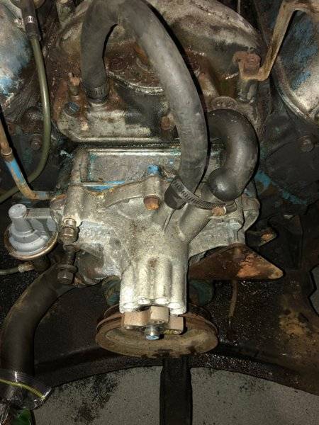

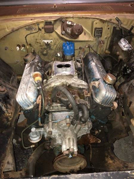

After I pull my motor, degrease, pressure wash, etc, I’m planning to paint it the correct red with Herbs engine paint. Can I paint the aluminum intake and water pump or will it require any special prep/primer?

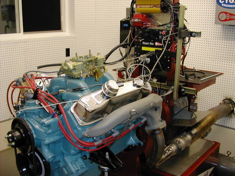

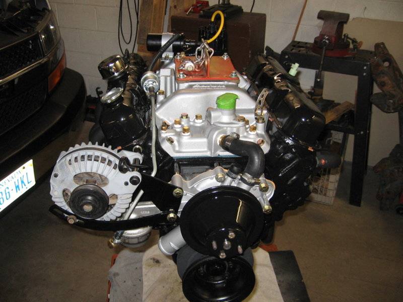

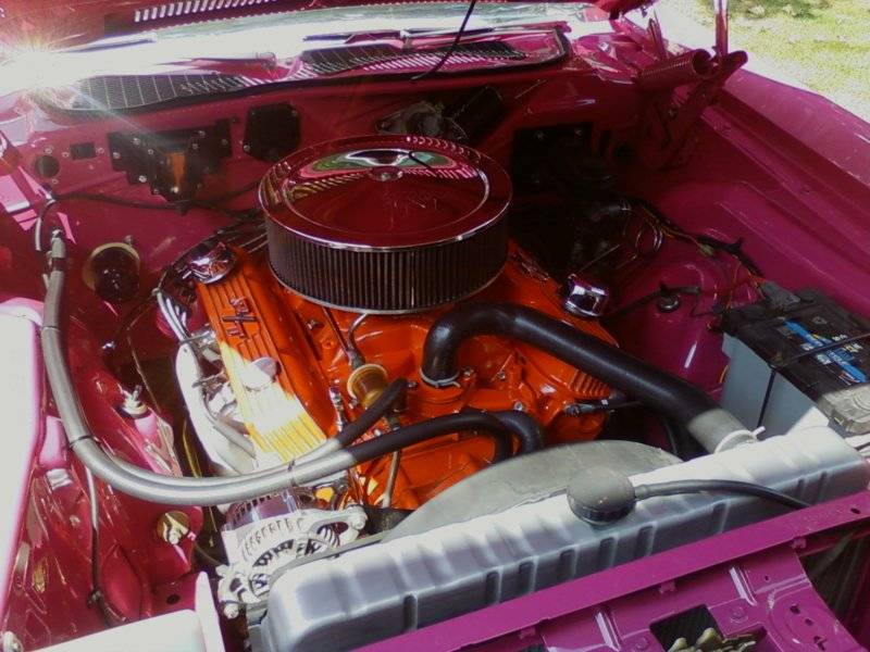

I have always liked DVW's close to stock appearing look also. I high pressure hot water tank cleaned (clam) all the parts first. Self etched primered my block, heads, intake, oil pan and water pump housing before painting Hemi orange with Plastikote. Then used their black wrinkle paint for the rocker covers. Mine is going on about 10 or 11 years old now. Touch them up at rebuild time.

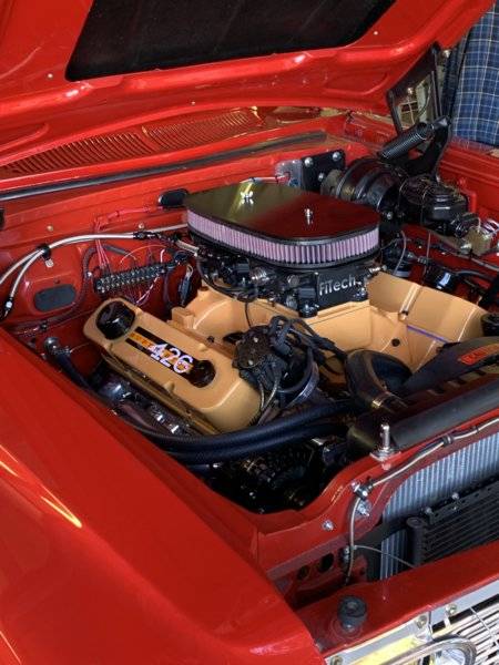

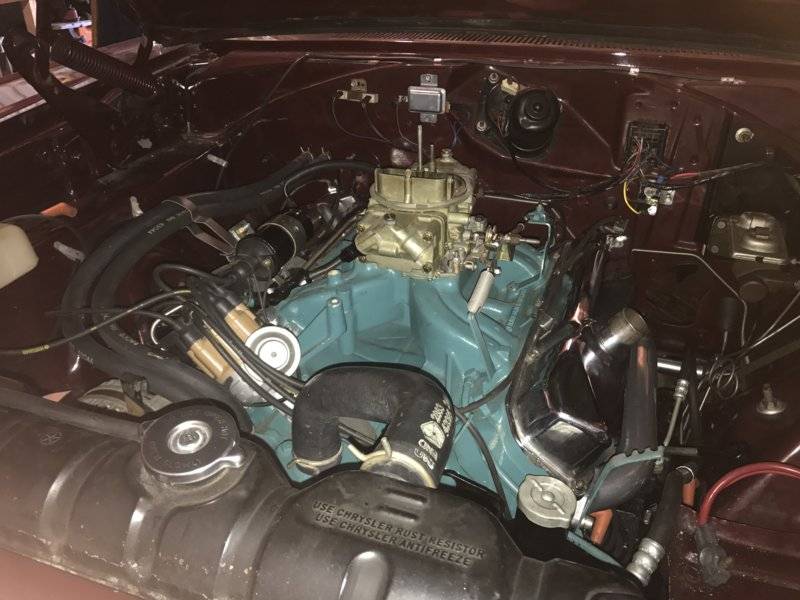

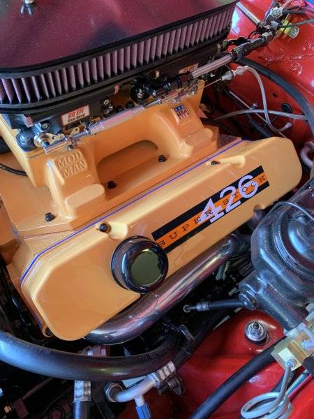

Painted my Holley street dominator intake.
DPLF epoxy primer and PPG acrylic enamel.

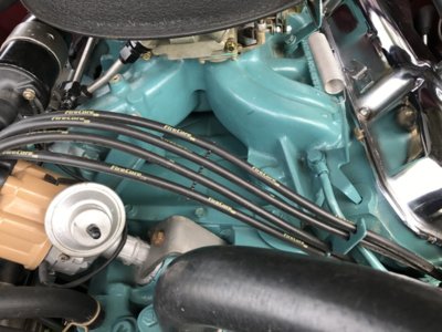

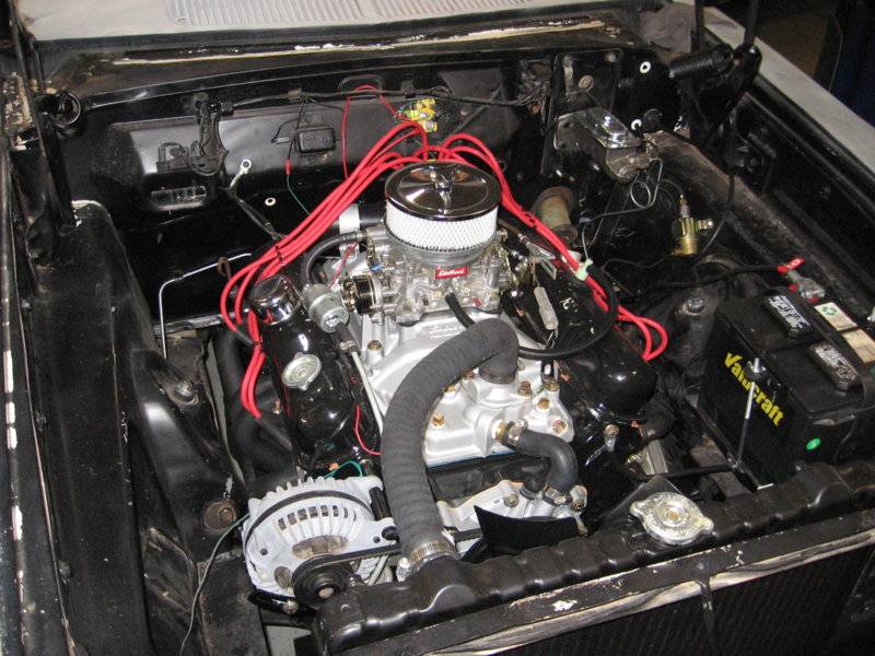

I painted my intakes with a ceramic silver. I believe it was Rust-olium or Dupli-color Fuel resistant. The small block intake,fuel pump, and waterpump all painted. Didn't do the alternator "yet".Boy you can see the difference.
3 years old now.

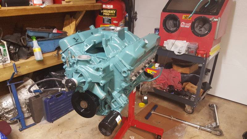

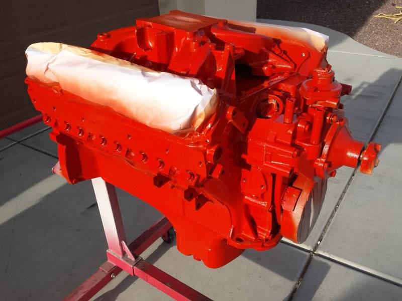

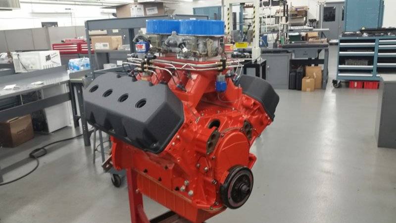

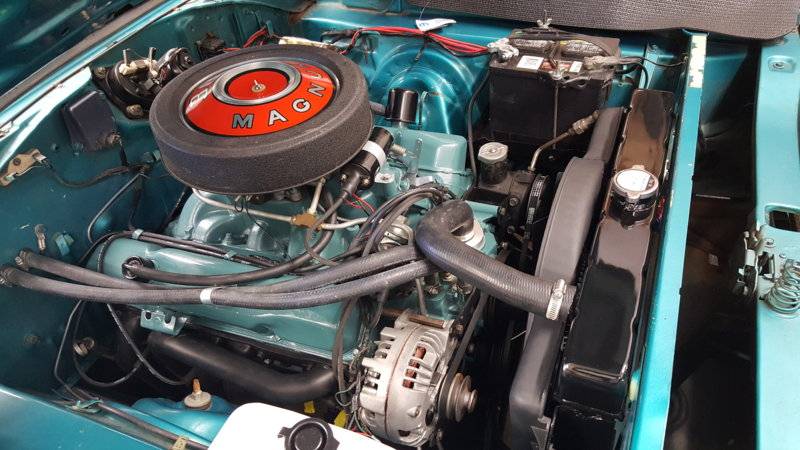

Prime and paint. This 440 was done with SPI epoxy primer and single stage u-Tech in hemi orange. Aluminum water pump, heads and intake...
