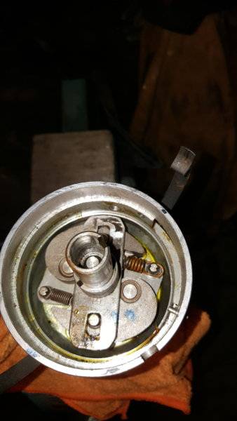

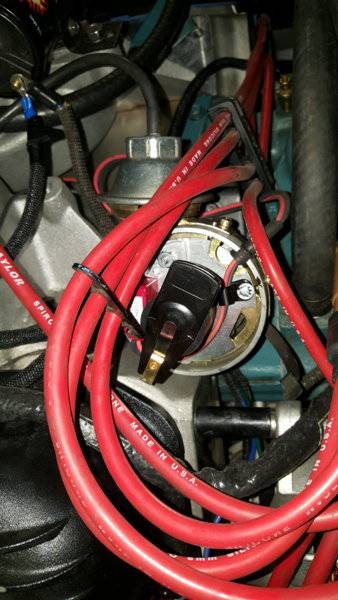

Ordered an advance plate and spring kit from FBO. Now my mechanical advance is more accurate. I found the FBO plate to be off 2 degrees though. The engine seems to like 16 initial and 18 advance starting around 1800 to all in at 2500.
View attachment 765915 View attachment 765916

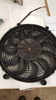

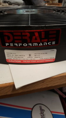

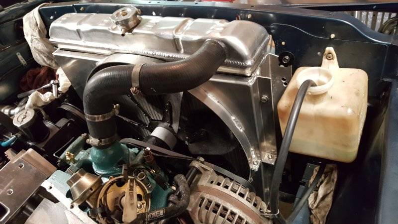

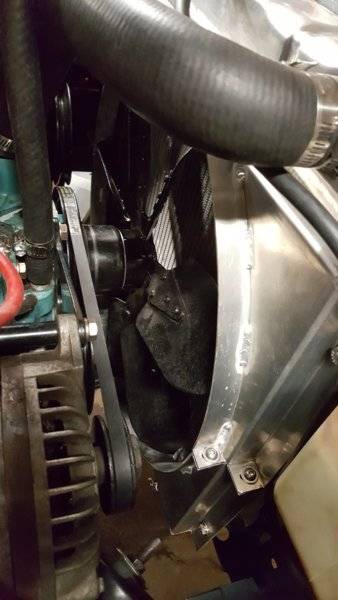

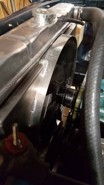

Just my 2 cents but if it maintains 195 on the freeway but gets hot idling your fan or shroud are the issue not the radiator, you need more air moving. Wish I could point you to a certain setup but I just threw twin Spal electric fans on mine and was done with it. I'd suggest possibly going to a smaller water pump/fan pulley then put a thermal clutch fan on it that way your increasing the fan cfm but not eating up horsepower at cruising speeds. Just my thoughtTest drive to a local car club meet was fine as was a two hour drive to moparfest. Temperature stays at 195 on the highway at 3200rpm but crept up to 205-210 when idling for any length of time in the afternoon. I think the 22" rad might be a bit small for this engine so I will probably add a pusher fan.
Before i moved the fan
After
View attachment 640777 View attachment 640776
