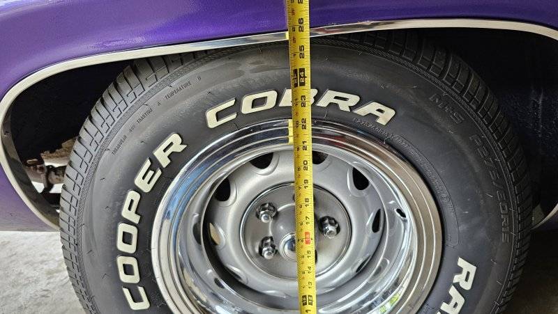

Can someone tell me their rear ride height on 71-71 B-Body?
Myasylum
9:11 AM
May 10, 2020
459
164
53024
My springs seem to be weak (look at previous thread) but I'm at about 25 1/2 inches which I think seems about right?? I need to know for sure though before I buy new springs.
Need stock height with good springs please.
Judging from the original brochures....even tho they are drawings obviously styled from actual pictures....... It looks like you are right on...not sagging one bit. Of course that does'nt mean they aren't weak as h*ll, judging from your other post about hitting the floorboards. Maybe just new stock height HD springs and a pinion snubber is what you are looking for?? BTW, even tho some peeps said you don't want SS springs.... you know those puppies will rise on strong acceleration, not bottom out severely like your did?? You may even do well to add some clamps to the spring pack to get yours tuned a little better.
https://www.motorologist.com/wp-content/uploads/1972-Plymouth-Satellite-brochure.pdf
Perfect! Yes, I did see those brochures and noticed they were drawings. I was like... come on?! Really?!. Lol.
