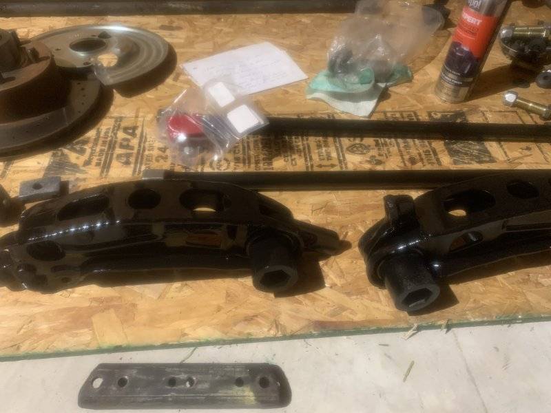

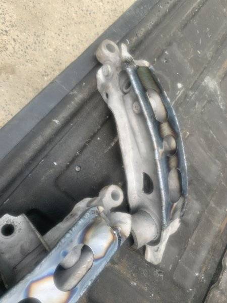

Glad to see you found it!!Hat off to all y’all seen something wrong , it’s LCA bent like horse shoe ,, rebuild kits not going to help this , hard to get picture
Sucks but at lease I know one of her troubles
Ya bent bad , I didn’t notice till I was going clean it up and remove old bushing , The torsion Bar was hard to remove on that side also .The one the the left looks bent badly
Looks ok best I can tell , cleaned and didn’t see any sign of damage , the new shaft fitts snugHave a look at the k-frame too where the LCA shaft goes through. Look for cracks, wallowing out etc. Another known problem area.
Ya I seen a set on there for 350 , money I hadn’t planned on spending , but you’ll have that ,Seems to be one on ebay, not the cheapest but at least it doesn't look rusty.
Mopar #2535367 1970 Dodge, GTX, Charger B-Body Left Lower Control Arm
Yeah, unless you really want it to look original. Also, not sure you can use the 70 sway bar on that one..Id rather have Qa1 than pay that price for who knows wat
