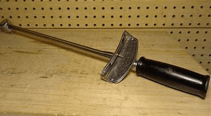

I went back to Autozone and was actually tempted to purchase what I used back in the 1970's--the "old-fashioned" but reliable bent bar type for about twenty bucks.

those type torque wrenches are the most accurate in my opinion.
too much "over-torque" can be had on the clicker types if one hears and feels the click, then goes "just a tad" more".........
