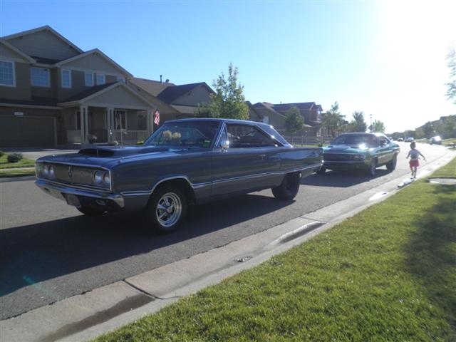

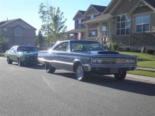

I have a 67 Coronet with 275/60.
Yes the tire will fit with no modifications..
Although the 7 inch wide rim is acceptable,an 8 inch is best with a 4.50" backspacing.
It will be a tight fit and may rub the right side inner wheel well under load or over bumps.
The cure for that is install air shocks and raise the car until it stops rubbing-aprox 1/2inch or 40 psi in the shocks.
Monroe part # MA757
I work at a tire shop and had helped other members here as well.
Hope this helps.
