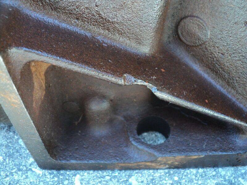

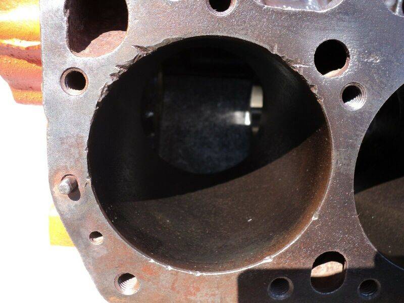

I'm not looking to buy this, i'm not even building engines but i'm curious how serious this kind of damage really is?
And since i'm so curious and knowledge never hurts i decided to ask you guys. :)
I imagine it can be fixed since the guy is asking $$$ but how serious is this and how would one be going to fix it?
I would also imagine the second "issue" is minor and can be left alone?
Unless that is some super rare engine, I'd pass on it. Sure, it can be welded and machined but with so many other engine blocks out there in better shape, this may not be worth the effort. Do you know what happened?

I didn't look at the price but there is nothing so severely damaged that would cause me to shy away from using that block.

Block can be sleeved, not sure what that costs now. That makes this block worth just a bit more than they spent on that shiny orange paint they used in their "prep".

That block doesn't need a sleeve. The damage isn't that severe. If you own a torch, fill those dings with braze.

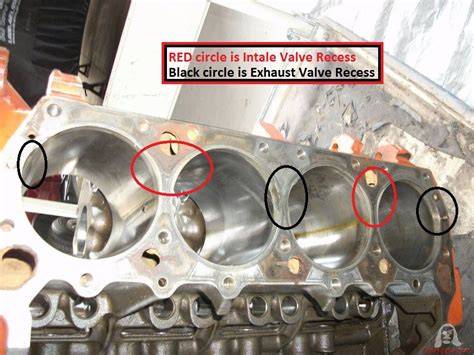

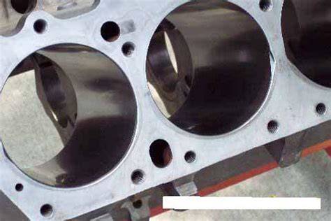

Max wedge valve reliefs cut out part of the deck, 2 on each cylinder. Do some measuring on a stock head gasket, or use a larger bore head gasket for a 540/572 engine.
Forget about this particular block, seller is foolish.
