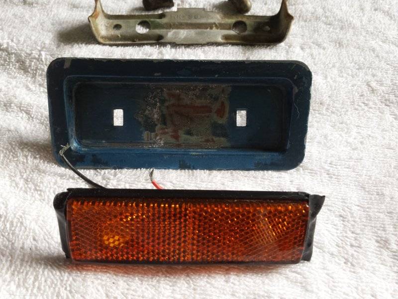

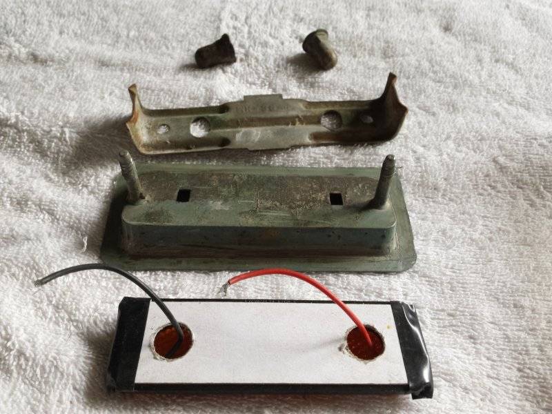

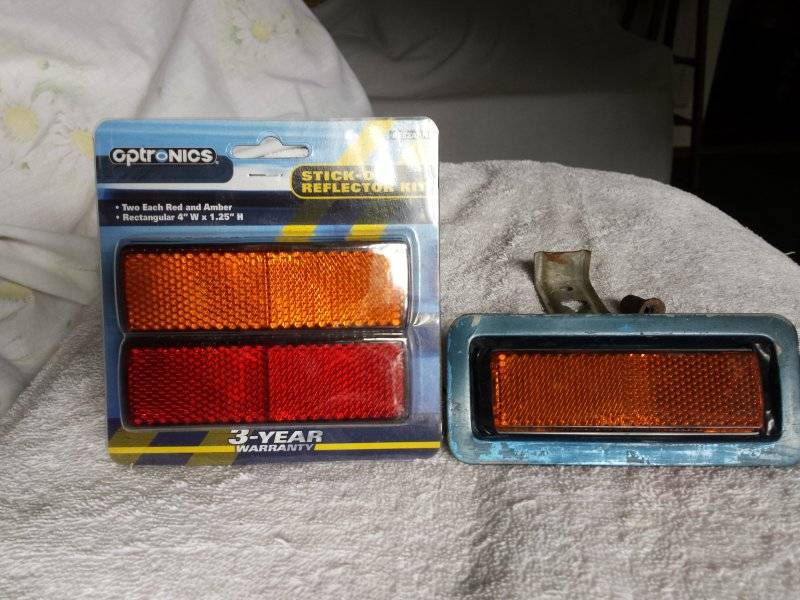

I added led's to mine. But not on the car yet. Purchased 4 reflectors at advance auto parts for $10 two red /two
Amber in the pack. They are the correct height but a little short on length which gives you room to put led's on each end they light up nice! I have electrical tape on it now. But will cover the led ends with urethane caulk to be more permanent.
Amber in the pack. They are the correct height but a little short on length which gives you room to put led's on each end they light up nice! I have electrical tape on it now. But will cover the led ends with urethane caulk to be more permanent. View attachment 1340571View attachment 1340574
Part # RE52ARK Made
by Optronics
