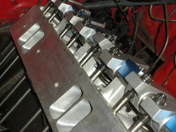

Can you tell me how this happened?
I'm inclined to think the valve springs are too weak and this may happen again on a different piston. I doubt the valve would stick open as the cylinder would push it back up
unless the valve stem is slightly bent. And that's the second issue you may have. I fear to drive with confidence, that heads going to have to come off. That or roll the dice.

Sounds like the rockers were adjusted with no lifter pre-load? I use 1-turn pre-load, which is 0.0417" with a 24 TPI adjuster, or 0.050" with a 20 TPI adjuster. Crower recommends 0.020" min, to 0.050" pre-load.

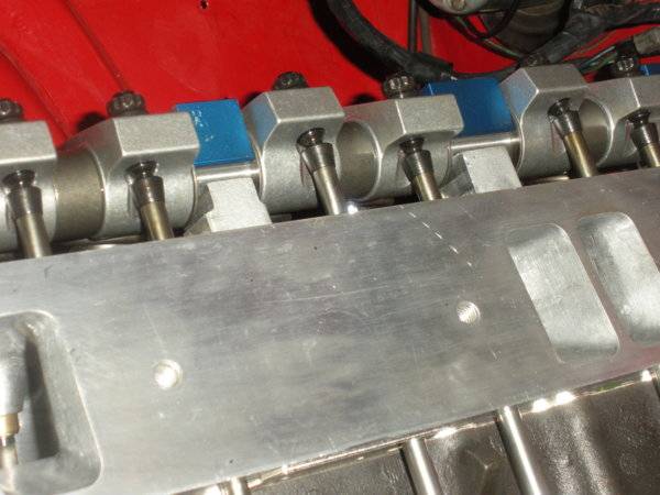

Also, Pull the rocker arms/shafts, and make sure the rockers rotate freely. Had the stainless rocker gall the shaft on a set. Comp said to hone the rockers for extra clearance.
Sounds like the pushrods are not rubbing on the head, but check just in case. Looks like 5/16" pushrods, so should be OK. Usually the 3/8" pushrods will rub if the head is not clearanced for the larger pushrod.

The .020” preload minimum that Crower recommends is very close to half a turn (which they also recommend) based your description of the different adjuster threads. That means I’m in the safe zone again by adding a half turn of preload, and could probably go a full turn max.
I think the 0.020" minimum is the pre-load with the engine at operating temp. If you are setting the pre-load cold you might want to add a bit more, especially with aluminum heads.
