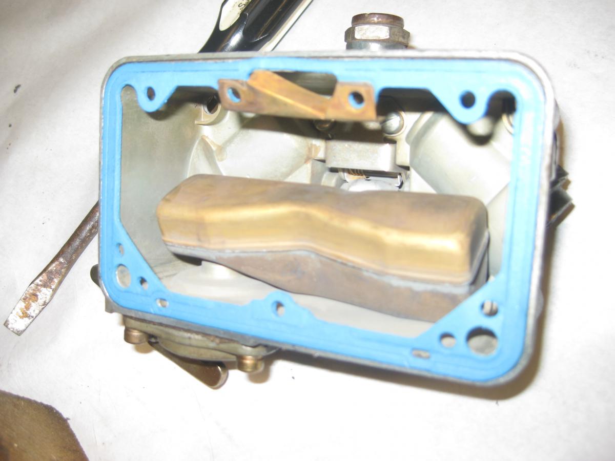

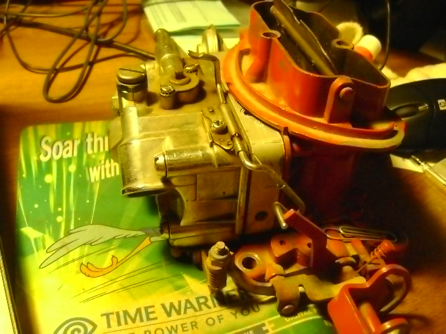

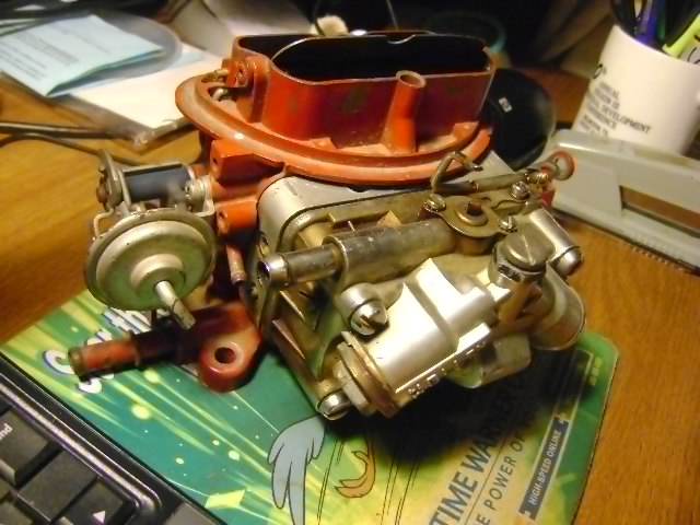

Can someone please tell me where I find a bowl for the center carb in a holley 6 pack set up?? List 4144-1
Everywhere I call says it's discontinued and Holley says they dont stock it but they can order it from their factory which will take 30 days and "won't be cheap" to quote their rep.
As you can see from the 3rd picture the threads for the float valve are shot.

That looks like an outboard to me. The center carbs I see have a vent covered by a lever. I have two spare center bowls with vents, one stock and one chrome, let me know if a used one is OK and we might be able to work a deal.
I decided to order it from Holley It turned out to be only $60 with the float which I also needed, Are you near Valley City? I bought my car out there.
Yep, I play in a band at their fire department festival every August.
If you got a replacement bowl like the one in the picture for $60.00 I'd say that's not bad. That needle and seat thread size is 3/8-32, so if you can find a helicoil kit that cost's less than a new bowl I'd say fix yours - or take the bowl to a machine shop for repair.
