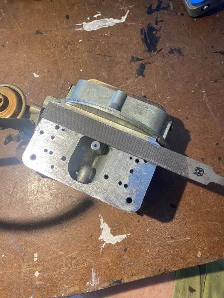

I Filed Down my carb since the edges where a little high.
I put it back on the 440 and it ran better then ever! I also got really god response on the idle mixture screws.

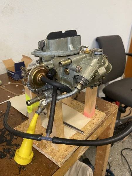

I then took the carb to the bench, filled it with gas and after 4 days there is no signs of leaks and fuel level is the same.
