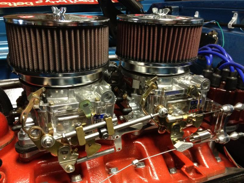

can't get full throttle with my pedal. when I push it to the floor it only gets about 2/3 and the cable is tight. I shimmed the lever to try and extend the range but still can't seem to figure out how to get full range. I am using a Lokar throttle and kick down. Any ideas? here is a pic of my setup on the engine. (the kick down has not been cut to length in the pic so disregard that)

Is the dual carb linkage correct, looks like the front will open quicker then the rear?
If you open up the little hole that is in-front and a but lower of the current position, and use it to mount the throttle cable it will move the the throttle cable closer the the carb shaft/pivot, and give more clearance between the cable clamp and holder/adjuster.
Looks like the kickdown is not attached the the transmission yet?
Also, the long bolts holding the link bars might hit the carb body?
The linkage is set so both work simultaneously, the front opens as the back opens. The cable does not hit the bracket so there is enough room for full throttle there as I can push to WOT at the carbs , it's that the pedal hits the floor before WOT can happen. need more arc in the pivot. The bolts look long but plenty of clearance. As mentioned in the post, kick down was not cut and adjusted in this photo. Thanks for all the tips.
