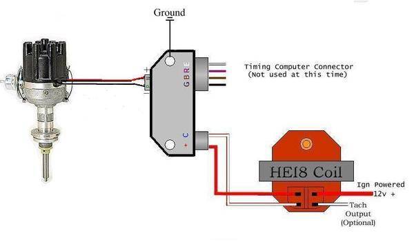

Well I'm totally confused. From full load to turning off just the headlights works, it doesn't sound like RF to me anymore. Your test of running the coil directly off the battery and the car running fine is telling us something. So it likes the voltage/connection from the battery but not from the blue field wire even though you said you had 13.5V at that point. I believe you said you bypassed the ballast resistor. I'd say to try to find another switched 12V source but you have to find one that is not shut down by the momentary start position of the ignition switch. I'm sure someone will know where to find such a source. Also, if that ignition module is mounted on the distributor it will need to have a good ground as shown.

ign module is mounted on firewall with ground wire running to engine. Also remember it only misses when car reaches temperature. with all things turned on during
