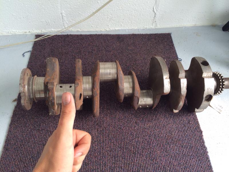

yeah, after i measure the pick-up distance i will be taking the top end apart. When i first got the car running, i told myself that if something happens to this motor (pretty much stock 1977 cordoba??) i will finally build the 451 i have always wanted.
well a forged 440 crank fell in my lap yesterday at work
