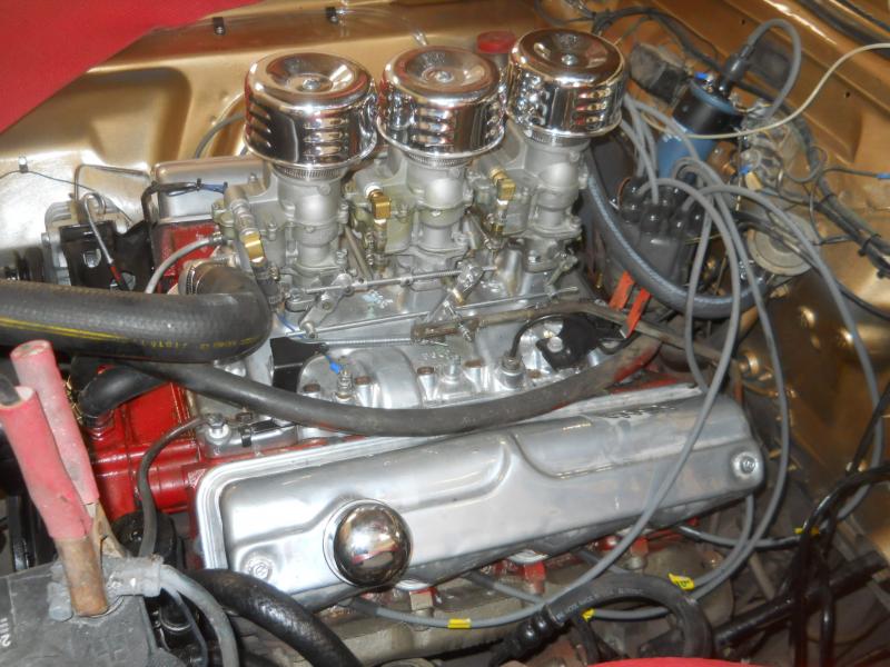

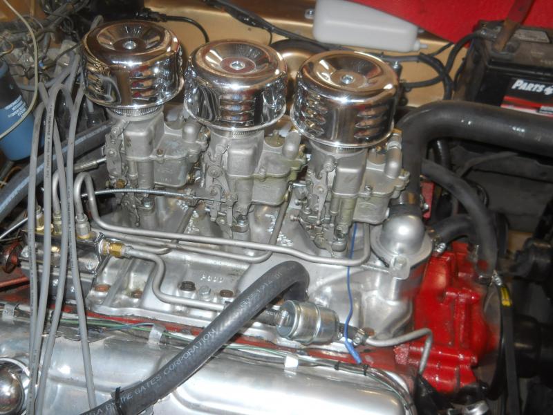

I just rebuilt 3 2bbl.carbs and they came out beautiful. I used Eastwood renew 2 carb paint on them 001.jpg002.jpg car is up and running great! disassemble the carb completely and soak all parts over night. reassemble with a carb kit and your set to go.
